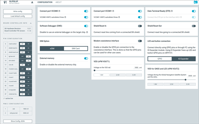

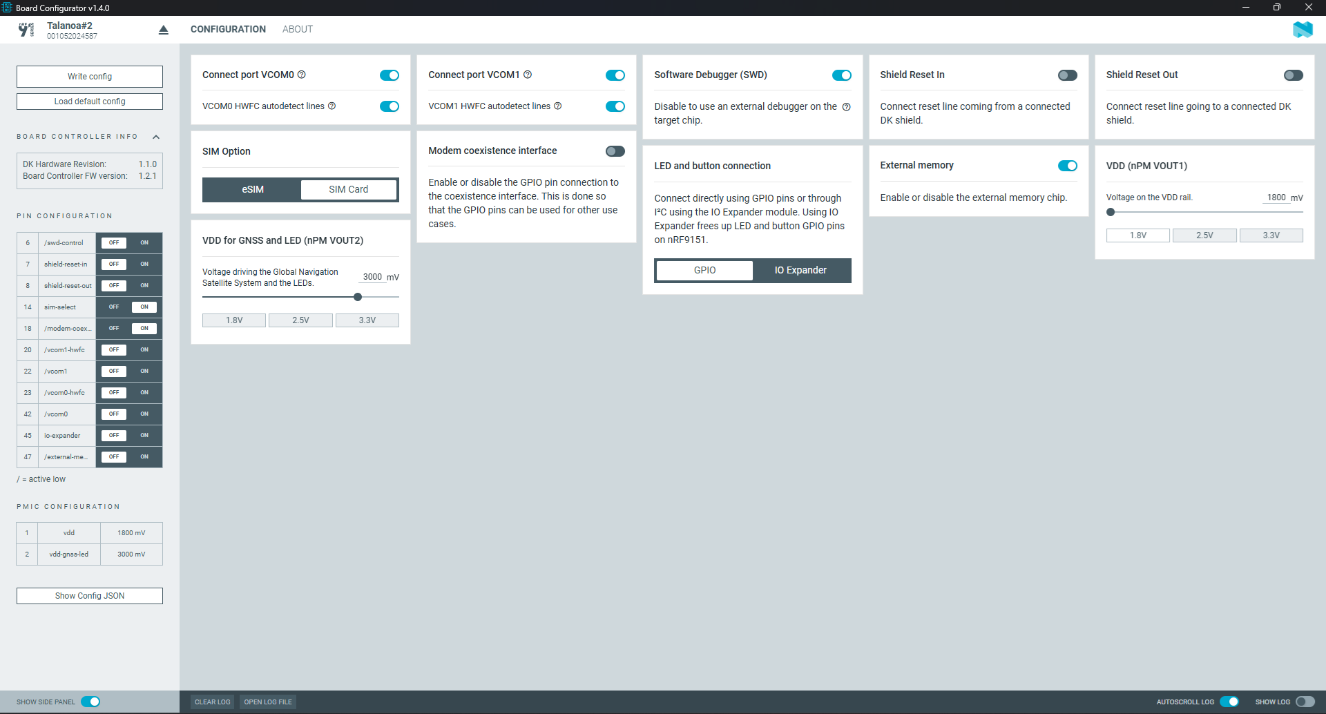

Environment
  • Hardware: nRF9151 SMA DK (multiple boards available for testing)
  • nRF Connect SDK: v3.4.0
  • Zephyr OS: v4.4.0-bf801e4e3d19
  • Sample: nrf/samples/dect/dect_shell
  • Board target: nrf9151dk/nrf9151/ns
  • DECT NR+ modem firmware: mfw-nr+_nrf91x1_2.0.0
  • Region: EU
  • Band: 1
I configured one board as FT with Long RD ID 1 and another board as PT with Long RD ID 2.

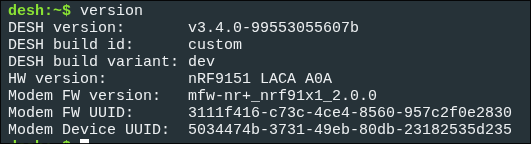

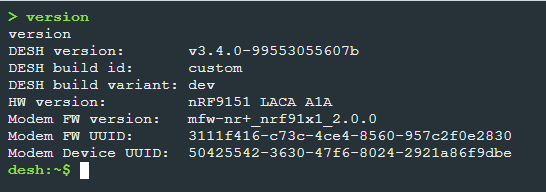

    Is mfw-nr+_nrf91x1_2.0.0 the correct/recommended modem firmware for the dect_shell sample in NCS v3.4.0?
    Yes, this is the same one as I used.

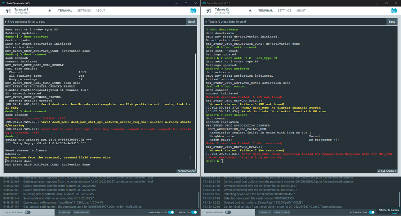

  • Hi Simon,
    Thanks for your reply and for sharing your compiled firmware.
    I flashed with nRF Desktop Manager 5.4.0 - Programmer the tfm_merged.hex you provided on both of my nRF9151 SMA DKs and unfortunately I am getting exactly the same issue, so it does not seem to be related to my own build or Kconfig/overlay configuration.
    Screen capture :
    /resized-image/__size/1600x696/__key/communityserver-discussions-components-files/4/pastedimage1789495236655v1.png
    I first deactivated and reset the settings on both DKs:
    dect deactivate
    dect sett --reset
    Then I configured one DK as FT:
    dect sett -t 1 --dev_type FT
    dect activate
    dect connect
    The FT successfully creates the network on channel 1657:
    Cluster started/reconfigured at channel 1657.
    FT: network created
    On the second DK, configured as PT:
    dect sett -t 2 --dev_type PT
    dect activate
    dect connect
    The first connection attempt reports:
    Network creation failed: 5 (RD not found)
    No cluster channels stored
    No cluster found with NW scan
    When I run dect connect again, the PT apparently finds the FT and starts the association, but it then fails with:
    DECT_ASSOCIATION_REQ_FAILED_MDM:
    Association request failed in modem with long RD ID: 1
    Neighbor role: Parent
    Modem cause: No resources (7)
    Network creation failed: 7 (No resources)
    And finally:
    Modem operation failed for Association Response with err MAC_STATUS_NO_RESOURCES (7) with long RD ID: 0x1
    So the important point is that the exact same MAC_STATUS_NO_RESOURCES (7) error occurs with the firmware you compiled and provided, on my DKs.
    I have attached a screenshot showing the complete FT/PT sequence.
    Since we can now reproduce the issue on my hardware using your known-good binary, what would you recommend checking next?
    I can also test the DKs in different FT/PT combinations, and I have a third nRF9151 SMA DK available, so I can check whether the problem follows a specific DK or occurs with every PT.
    I can also provide the complete logs and enable modem trace if that would help.
    Thomas
