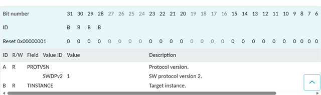

    ''1. Does production nRF54L15 silicon correctly respond to SWDv2 TARGETSEL using its fixed TARGETID and TINSTANCE = 0?
    According to documentation DLPIDR • nRF54L15 | nRF54L10 | nRF54L05 Datasheet • Technical Documentation, it seems relevant to your case.
