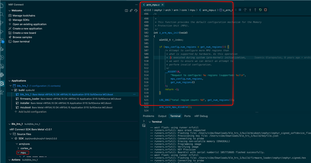

    The MPU is already being configured on startup through the zephyr init code based on Kconfig settings and the chip's memory described in the board devicetree files:
    RAM should be set to non-executable by default, but you can verify this by reading out the MPU configuration register or by trying to execute code from RAM.

  • Thank you for the reply. I may be misunderstanding the architecture, but the code shown in your screenshot appears to come from Zephyr, while we are using nRF Connect SDK Bare Metal.
    My original question came from finding the MPU HAL in the nrfx documentation. We are evaluating whether the Cortex-M33 MPU can be used to segregate parts of our application and protect selected code and data regions.
    Could you clarify whether the Zephyr MPU initialization shown in your screenshot is also used by a Bare Metal application and, if so, how we can add a custom protected memory region?
    Thank you.
  • Yes, the Bare Metal SDK also uses some code from Zephyr and that is what my screenshot shows. I am not sure if you are building from the command line or through the extension, but the extension makes it easy to browse what files are included in the build.
    That said, this code is not implemented as a generic driver. It will initialise the default regions and enable the MPU on startup but it does not expose APIs that will allow you to configure regions from your application, so for more advanced usage I would consider making my own driver using the Zephyr code as a reference.
