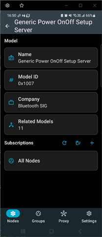

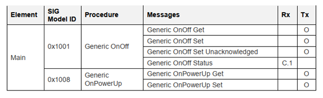

I want to change the setting of the "Generic OnPowerUp Set" on the Generic Power OnOff server, how to use nRF Mesh APP to do it?
What setting of the "Generic OnPowerUp Set" on the Generic Power OnOff server would you like to change?
Not sure what you want to achieve. Maybe you can refer to this doc on how to use the nRF Mesh mobile.

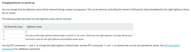

The NCS v3.4.0, bluetooth mesh light fixture (light_ctrl) sample, in the
bt_mesh_ponoff_srv_set(&light_ctrl_srv.lightness->ponoff, BT_MESH_ON_POWER_UP_RESTORE);

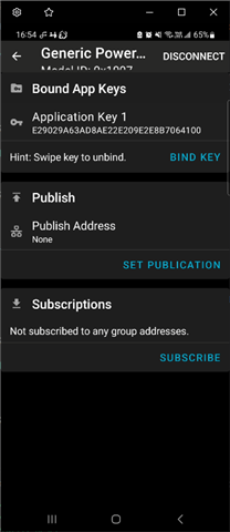

James168 said:Can I use nRF Mesh APP to change this value?
You can set "Restore" to the last known Light level in the Control under the Generic Power OnOff Setup Server on Element1 via the nRF Mesh APP on iOS after binding the application key.

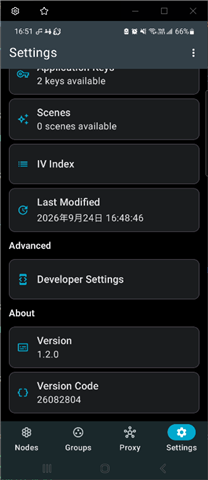

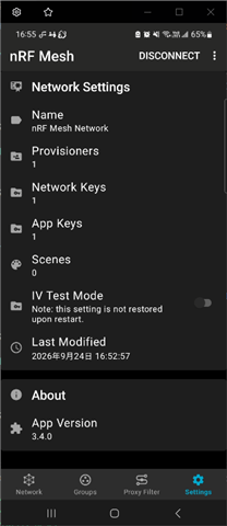

The android version APP seems not support this function? I don't even see the Control section.
Kotlin version:
Java version:
James168 said:The android version APP seems not support this function?
No. The function is not added to the Android version.
