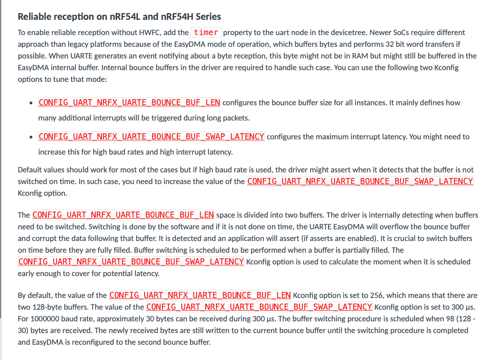

We have also tried using the modem_backed_uart_async option, which balances the PM usage correctly, but suffers from the known RX timeout problem with UARTE. We are currently trying the async driver with the CONFIG_UARTE_NRFX_UARTE_COUNT_BYTES_WITH_TIMER Kconfig option, which seems use a separate timer peripheral for the RX timeout, but we do see some performance problems (some CMUX frames missing bytes), so it isn't an easy win.

    I will forward this to the developers to check if they can confirm the issue with the ISR version. Will update the ticket here as soon as I have heard back from them. Regarding missed frames with the async driver, maybe you did it already, but enabling HW byte counting on nRF54L series with the TIMER/COUNTER requires specifying the timer instance to be used under the uart devictree node like done here: https://github.com/nrfconnect/sdk-zephyr/blob/56e06d37288a9b25d0f399faefbda439134d1dd2/tests/drivers/uart/uart_async_api/boards/nrf54l15dk_nrf54l15_cpuapp.overlay#L45. Documentation on how to enable reliable reception with HWFC for reference: https://nrfconnectdocs.nordicsemi.com/ncs/latest/nrf/drivers/peripheral_drivers/uart.html#reliable-reception-on-nrf54l-and-nrf54h-series. Also, probably unrelated to the missed data, but I recommend enabling CONFIG_UART_NRFX_UARTE_HFXO_ON_ACTIVE if you aren't already requesting the HF crystal oscillator from your application. The HFXO ensure that you will have a sufficiently accurate baud rate across temperature and devices.

    We have tested with the separate TIMER/COUNTER specified to handle the RX timeout, and this works in terms of not ending up with the RX disabled randomly, but the CPU load seems so high when running at 921600bps that the CMUX driver is dropping bytes. I am not sure if this is dropping at the modem backend level, or at the CMUX driver (on ncs-3.3.0 with earlier modem code we had a lot of trouble tuning all the buffer sizes through the modem and network stack to make sure that we were not dropping data there.

  • You should be getting the UART_RX_STOPPED event if frames are dropped due to excessive clock drift. However, it sounds like perhaps the data is not being lost by the UART driver itself, but at some layer above it.
    The root cause of the reception issues we have had on the nRF54L (which seem to be the same one described in the DevZone thread you linked) is that the EasyDMA for UART operates differently on this device than on previous generation nrf devices as described here:
