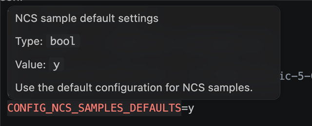

Problem
Kconfig navigation does not work from the application’s  prj.conf . For example, Go to Definition on  CONFIG_NCS_SAMPLES_DEFAULTS  does nothing, although the project builds successfully and the symbol is present in the generated  .config .

  • select CONFIG_NCS_SAMPLES_DEFAULTS and press F12
  • Expected - navigates to <ncs>\nrf\samples\Kconfig
  • Actual - nothing happens

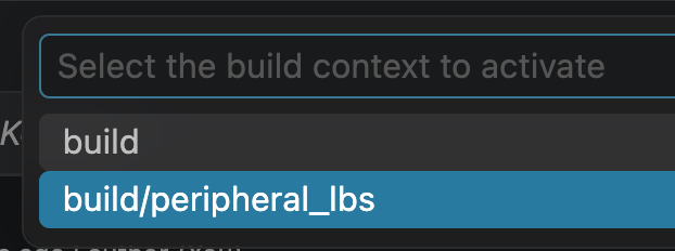

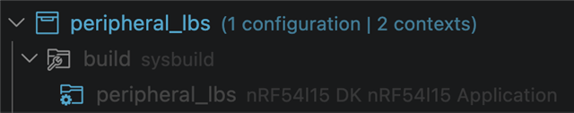

  • Hi, with sysbuild you must select the child as the active build context, otherwise the extension does not have the context to show KConfig information.
    Pay attention to this in the bottom right corner.
    Click it, then select the child:
    and it should work
    We know this is not a great user experience. If you aware that selecting the child makes a big difference for the context, it helps a little.
    This is also reflected in the KConfig GUI. Try it with the build selected and you only see a few KConfig options for the sysbuild.
    Then select peripheral_lbs, and open KConfig GUI again, now it has lots more options because it shows options for the domain.
