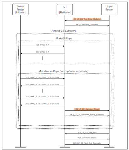

I am currently testing LE Channel Sounding using the nRF54L15 DK.
I am performing an HCI LE CS Test using Main Mode 2, and I am parsing the HCI_LE_CS_Subevent_Result event to check the tone_pct values.

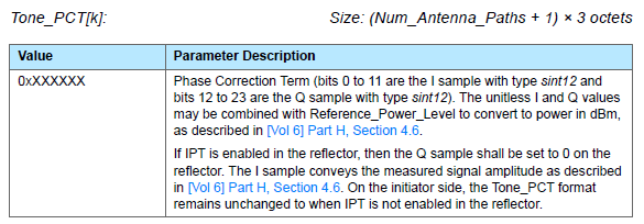

1. How are the I/Q values in tone_pct measured and calculated?

In other words, I would like to know whether the I/Q values provided in tone_pct through HCI are raw measurements, or whether some kind of phase processing is applied internally.
4. Could you provide a detailed definition of tone_pct?
In particular, I would like to understand:
  • What I and Q each represent
  • The reference used for the I/Q values
  • The sign and scale of the I/Q values
  • The physical meaning of tone_pct
  • Whether the phase calculated from tone_pct can be directly used as a phase measurement for Channel Sounding
If possible, I would appreciate it if you could provide any documentation or information about how tone_pct is generated in the nRF54L15 Channel Sounding implementation.

In Mode 2, two signals are transmitted per step: the actual CS tone signal and the extension slot signal. Therefore, 19 × 2 = 38 data entries are parsed. Only when pct_index = 0 does the entry correspond to the actual CS tone signal.

    1. We can't go into how we do things within the SoftDevice controller feature set, as the internal processing algorithm is not open-source. It is done according to the Bluetooth specification though, but we can't go into details outside of that I'm afraid. Core 6.0 Vol 1 Part A §9.2 defines that
    "IQ values represented by the PCT" are:
    • PCT_REFL(f) = A_REFL(f)·e^(iθ_REFL(f))
    • PCT_INIT(f) = A_INIT(f)·e^(iθ_INIT(f))
    Expanding the complex exponential gives:
    • I = A·cos θ
    • Q = A·sin θ
    • Phase = atan2(Q, I)
    • Amplitude = √(I² + Q²)
    2. A single device's PCT phase is not a usable measurement on its own, even on a fixed channel. Even the same channel in two different steps or procedures can give different phases.
    3. There is not a phase reference/compensation you can rely on to make a single-sided phase usable from what I can see.
    4.Tone PCT is the complex baseband sample (I + jQ) of the received tone, with respect to the receiver's own reference. I is the in-phase component, the projection onto the local carrier's cosine reference. Q is the quadrature component, the projection onto the sine reference (90° shifted). atan2(Q, I) is the tone's phase relative to the receiver's own LO. √(I²+Q²) is proportional to the tone's amplitude.
    The phase can be used as an input to CS phase-based ranging, but not as a standalone measurement. You'll need the peer's PCT for the same channel, or IPT so the peer has embedded its measurement in the tone.
