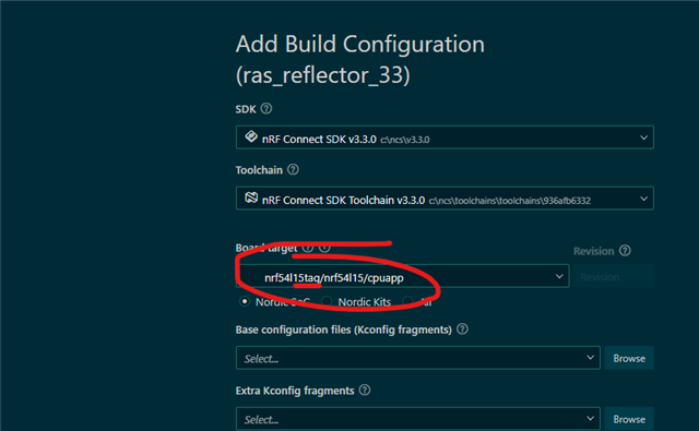

  • If you are referring to this, are you using the right build target? Using overlay files like what you are doing should be completely fine, but I believe there also is a "nrf54l15tag/nrf54l15/cpuapp"? If it doesnt show up in VSC, you might need to check the box for all boards being visible.
    Elfving

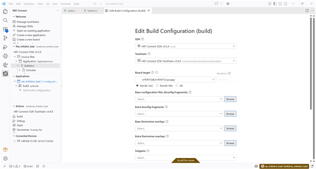

    Yes, I'm referring to this tag. I am not sure whether there should be a separate overlay file since it's another device really. I did not find any documentation about it.
    I include the ras_initiator_bad project, which is based on the original ras_initiator project with the functions button.c and event.c added. In main.c I added button_init(), which is where things go wrong..
    Callback function button_event_handler() is just a test.
    I left the overlay nrf54l15dk_nrf54l15_cpuapp.overlay as in the original, although I tried various changes as suggested by AI.
    The sole purpose so far is a test to activate the button.

  • But did you try it with the build target nrf54l15tag/nrf54l15/cpuapp though?
