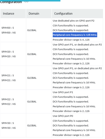

To use the nRF54L15 SPI00 and SDHC, I have to edit the SDHC file and add board-specific configurations to start at a 1 MHz clock, since the SDHC file defaults to a lower frequency than SPI00 requires. Only then does SPI00 work, but this approach doesn’t seem ideal. Are there any alternative solutions?
