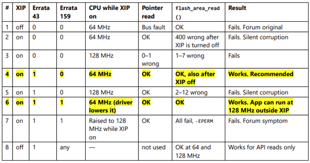

    The nRF5340 can read QSPI flash through a pointer at 0x10000000, but only while the QSPI peripheral is held in XIP mode. Errata 159 also requires the CPU clock (HCLK) to be 64 MHz for every QSPI transfer, and XIP fetches count. So with the workaround in place, you can't memory-map the flash and keep the CPU at 128 MHz at the same time. Without XIP, nrf_qspi_nor.c deactivates QSPI after every API call  qspi_release() calls nrfx_qspi_deactivate()). With PM it can also send the flash into deep power-down and uninit QSPI. A pointer read in that state gives a bus fault.
    I tried mirroring your setup with a nRF5340DK + 7002-EK shield, Wi-Fi fw patch in external flash and to read from the same range of addresses as you did.
    Pointer reads into external flash work when all three of these are true:
    1. XIP is enabled with nrf_qspi_nor_xip_enable(dev, true) before the pointer read, and stays enabled while the pointer is used.
    2. The errata 43 workaround is turned back on in the application CMakeLists.txt.
    3. The CPU runs at 64 MHz while XIP is enabled.
    With these, pointer reads and flash_area_read() both returned correct data in every test, including after XIP was turned off again. For 128 MHz, also turn on the errata 159 workaround and never raise the clock while XIP is on.
    # Application CMakeLists.txt, after find_package(Zephyr) zephyr_compile_definitions(NRF53_ERRATA_43_ENABLE_WORKAROUND=1) zephyr_compile_definitions(NRF53_ERRATA_159_ENABLE_WORKAROUND=1) # only needed for 128 MHz
    nrf_qspi_nor_xip_enable(qspi_dev, true); uint32_t val = *(const volatile uint32_t *)(0x10000000 + 0x780000); nrf_qspi_nor_xip_enable(qspi_dev, false); /* when pointer access is done */
    Might be a bit hard to read the matrix below, but these are the configurations I tested on bench.
    TL;DR: XIP is required for pointer read and the order of enabling vs reading is important.

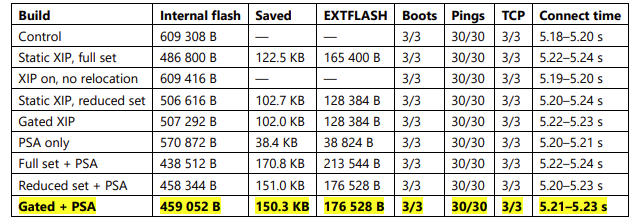

    Before those results are in, here's the results of relocating the hostap in xip on my setup. The Wifi FW patch is in the external flash using SB_CONFIG_WIFI_PATCHES_EXT_FLASH_STORE, and not SB_CONFIG_WIFI_PATCHES_EXT_FLASH_XIP (check which you have in the generated config).
    Pass Build Internal flash Boots OK Ping replies Connect time Idle current
    0
    Control
    609 308 B
    5/5
    50/50
    5.21–5.26 s
    1.392 mA
    1
    hostap code in XIP
    486 800 B
    5/5
    50/50
    5.19–5.24 s
    4.058 mA
    2
    XIP on, nothing relocated
    609 416 B
    5/5
    50/50
    5.18–5.31 s
    4.063 mA
    Current is as you see relatively high, and it might be higher as I don't measure the external flash usage here, only VDD_nrf through a PPK2 and as of now the external flash is on VDD_PER.
    Andreas

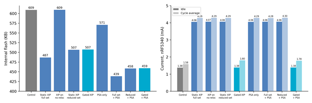

  • Hi again,
    Results are in. I'll start with answering commenting on your latest reply and then go through the results. I won't share the full generated report to start with because I think that might be too much information to have any meaningful conversations around it, but I can share it at a later point if you and I think thats of any use. For now lets just have a look at the compiled configurations and results:
    BrianW said:
    I guess the current being nearly 4x higher with XIP on is just beacause it leaves the HCLK192 at DIV1 and not DIV4? Or are you running PM and getting the enter_dpd/exit_dpd benefit in non-XIP mode?
    I'm not running PM - maybe this is causing some of my high 'sleep' current...
    HFCLK192M left at /1 instead of /4 is part of the XIP cost, but it isn't everything that contributes to an increased consumption.
    PM is off in all of these builds, and as you can see in the results I discuss in the following wall of text I see about an 2.9x increase when comparing it to the baseline application.
    We do also not enter deep power down for the mx25 flash chip on the nRF5340 in this test bench as far as I can see, meaning that the external flash is on standby at all time.
    Errata 43 and 159 are taken into account in my test bench.
    BrianW said:
    we are already in production and deployment. Currently I am trying to squeeze more functionality in based on customer projects - and trying to get the wifi enterprise stuff in there is a problem....
    A bit of speed hit is managable, but a battery hit will be a problem - I'm already struggling with my sleep current on the board (up around 5mA when it should be <1mA). That said, I'm pretty happy with the current used in operation with the wifi connected running MQTT....
    There might be some gains for you here, but I think we might have to lower our expectations w.r.t gains both on memory saving side and on consumption side.
    Results were somewhat as expected, but also somewhat better than expected w.r.t current consumption.
    I've used a relatively simple application in my test bench, meaning that it's easy for me to get an overview over all entry points into what requires/triggers XIP operation.
    The application you're working with most likely has more entry points, so take my table with a grain of salt when you read it. If yours have more entry points, then there might be that you have less potential for code to relocate.

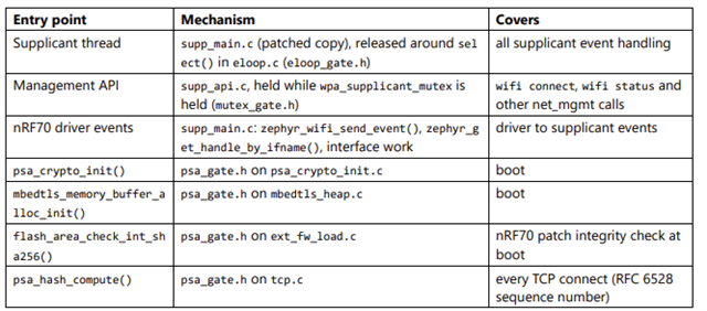

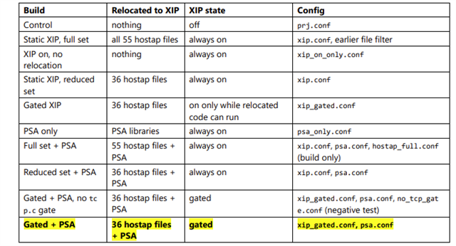

    Starting with the test matrix: I set up (or rather prompted) for a set of libraries, files and drivers to relocate and to check if we can find anything that causes a bus fault to occur and focused on excluding anything that depends on IRQs to be relocated to the external flash. This resulted in the following matrix:
    And the entry points in the gated builds:
    Memory wise we don't reach the 250kB mark you estimated in your guess.
    • Saved is how much internal flash the build frees: control internal flash (609 308 B) minus this build's internal flash.
    • EXTFLASH is how much code the linker placed in the external flash region at 0x10100000.
    At most I've managed to relocate within the specs I sat is as follows

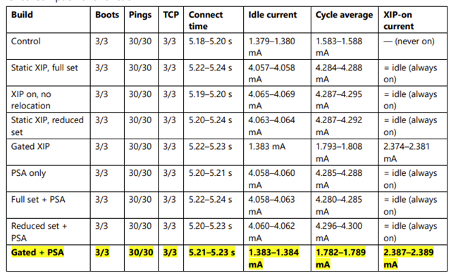

    Current consumption is as we've established still significantly increased when comparing to a non-XIP app. Note that here we see the difference between the "Full set + PSA" and "Gated + PSA". In the first, XIP is on all the time, whereas with the Gated variant we only do XIP when we enter any of the entry points.
    Do also note that I've not cut SB16 and shorted SB18 per the documentation to measure the consumption of the external flash, so the numbers may differ quite a bit.

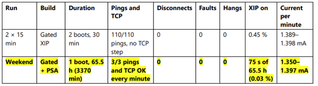

    I ran the last test over the weekend to check if I hit any bus faults over longer period of time, and it seemed to run without any crashes. Again, this is a simple app.
    XIP-on time is dominated by the connect sequence: about 4 s and 50 enables per boot. After that, XIP was on for about 1.1 s per hour during the weekend, mostly from the runner's own wifi status, TCP and xipg commands.
    Plots to compare the memory and current consumptions:

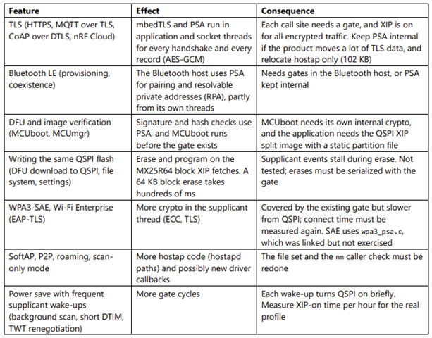

    Some comments for what to expect for a more "complete" wifi product:
    As a rule of thumb, relocate code that only runs in the supplicant thread, and keep anything shared with drivers, the network stack, Bluetooth or the application internal unless every call site can be gated. For a feature-rich product, hostap only (102 KB, gate in three files) is the lower-risk choice. Adding PSA (another 48 KB) is worth it when the supplicant is the only heavy crypto user.
    Let me know your thoughts when you've had the time to look through this and if you have any questions w.r.t the results feel free to ask.
    Andreas
