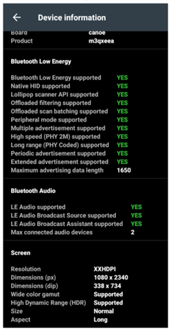

    Finally, can you please try to open nRF Connect for Android. There should be somewhere in that app where you can see the supported BLE features.
    I don't have an Android phone at hand, but you should be able to find something like this:
    Please check that LE Audio supported reads "yes".
    Edvin
    I tried the suggested steps. I added CONFIG_BT_AUDIO_PRESENTATION_DELAY_US=40000 to prj.conf, erased the nRF5340 Audio DK, re-flashed the application, and checked the phone for old bonding information.
    I also checked the BLE features in nRF Connect for Android, and LE Audio supported is reported as Yes.

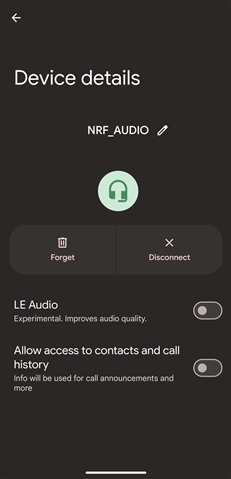

    Just to be clear, the Unicast server sample acts as a Bluetooth LE Audio headset.
    I am not sure exactly how this works on a Pixel 8, but you should look for the DK inside the phones Bluetooth settings, and see if there is an option to toggle LE Audio there. Do you see that?
    Edvin

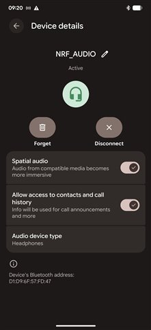

  • Hello Edvin,
    I checked the Bluetooth settings on my Pixel 8/8a after connecting it to the nRF5340 Audio DK. However, I can only see the Disconnect and Forget options. There is no option to enable or disable LE Audio or any other audio-related setting for the device.
    The phone connects and pairs with the DK successfully, but I still cannot see any LE Audio options.
    Could you please advise if any additional configuration is required on the nRF side? If you don't have a  Pixel 8 available for testing, could you please assign this issue to someone who has access to one so they can verify the behavior?
