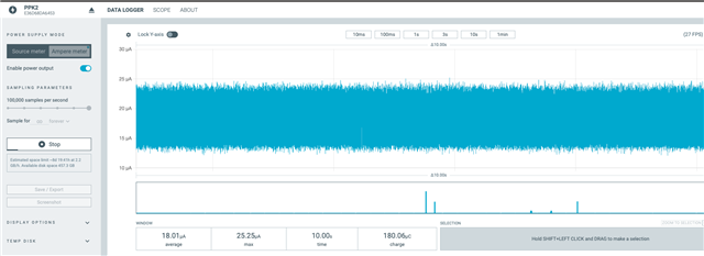

    It won’t keep the HF clock running, but it will still increase the floor current. I measure 18 uA in sleep (System ON) at 3 V with TWIS enabled on my desk with the nRF54l15DK emulating the nrf54l05 and the test sample attached below (built with NCS v3.4.1).

    PPK2 plot:

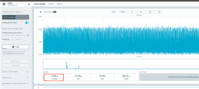

    EDIT: The nRF15L05 has the TWIS30 instance in the low power domain. Switching to that instance gave significantly lower power consumption in System ON idle:
    To test this you can swap out the content of the board devictree overlay with this:

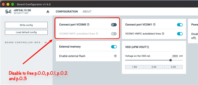

     * TWIS30 (LP domain) must use port P0. SCL must be on a clock pin: P0.04 (DK Button 3).
     * SDA: P0.02 (DK VCOM0 RTS, disconnect VCOM0 in Board Configurator).
    &pinctrl {
    	twis30_default: twis30_default {
    		group1 {
    			psels = <NRF_PSEL(TWIS_SDA, 0, 2)>,
    				<NRF_PSEL(TWIS_SCL, 0, 4)>;
    			bias-pull-up;
    	twis30_sleep: twis30_sleep {
    		group1 {
    			low-power-enable;
    &i2c30 {
    	compatible = "nordic,nrf-twis";
    	pinctrl-0 = <&twis30_default>;
    	pinctrl-1 = <&twis30_sleep>;
    	status = "okay";
    And if you are using the nordic DK, disconnect the UART lines from the interface MCU so they can be assigned to the TWIS instead.
