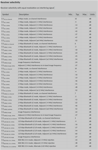

Does the nRF52833 receiver maximum input level, 1 dB compression point, or sensitivity-degradation threshold vary with frequency?
We are particularly interested in the following frequency ranges:
  • 2400–2483.5 MHz
  • 2483.5–2522 MHz
  • 2522–2800 MHz
  • Higher out-of-band frequencies
Could you provide or confirm the availability of:
  • Maximum input power versus frequency;
  • 1 dB compression point versus frequency;
  • Out-of-band blocking performance;
  • Receiver sensitivity degradation versus interferer power;
  • Typical blocking or desensitization test data?
    For a strong interferer in the 2522–2800 MHz range, even though it is outside the BLE operating channels, could it cause any of the following effects inside the nRF52833?
