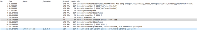

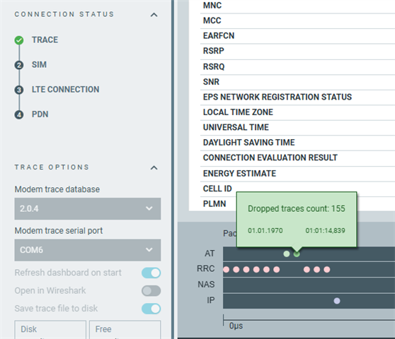

I'm working through the Cellular IoT Fundamentals course. In lesson 7 exercise 1 a modem trace must be captured. I'm following the instructions but the modem trace capture is mostly empty, it doesn't look anythink like the included "cellfund_less7_exer2.pcapng".
There are "dropped traces count" messages in the output, so I assume most of it was dropped. Is there a known limit on the nRF9151DK? Should the USB vitual com ports be able to handle the 1M baud throughput?
I did the same test with the Modem Shell application included with the nRF Connect for Desktop Quick Start. The result is the same, the capture is mostly empty and dropped traces.
The exercise says to use "Reset device on start" but there is no such option in the Cellular Monitor. Instead I start the capture then reset the board using several methods but with the same result: reset button on the nRF9151DK, reset through Connect Devices in VsCode, flashing again.

Cellular Monitor dropped traces:
Wireshark
Trace file
trace-2026-10-13T08-38-53.537Z.mtrace

    I repeated the test with a l7_e1_sol build. The device connects really fast (3-5 seconds), then starts the CoAP communication.
    On one of the attemps I did see a NAS-EPS event, but still the trace is mostly empty. E.g. it does not match with the number of CoAP messages sent. The trace file does keep increasing, like 1MB in this example, so it's strange so little is shown.
    The Cellular Monitor dashboard was not showing any data during a 3 minute test.
