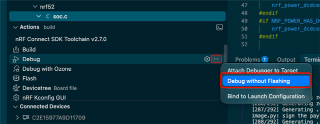

I also tried to start a debug session in nRF Connect for VS Code while retaining the full NSIB → MCUboot → application chain. I selected “Start a session on Application Core” and “Stop in My_Application at main()”, but the extension tried to program the sysbuild image and failed with:
-- runners.nrfutil: Connecting to probe
-- runners.nrfutil: Programming image
Error: One or more batch tasks failed:
* 1057728952:
Device error:
Address 0x00000000 is in a protected RRAMC region (Generic)
The device already has KMU/security information provisioned, so I have avoided running recover because I don't want to erase or reprovision the security state just to investigate this issue.
What is the recommended way to attach GDB to the Application Core/application ELF without reflashing the protected NSIB region?

    Debugging the protected boot chain
    Reprovisoining of KMU keys require an erase all (west flash --erase). To avoid this for debugging, you can select "debug without flashing"
