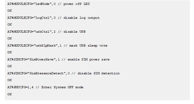

NRF93M1 DK not responding to AT commands
Initially, I can send and receive AT commands. But after sending the power-down commands
sequence from "Getting Started with nRF93M1 DK v0.4"
I could not receive any response from AT commands. I tried power-cycling
the DK and toggling the Reset and Power Key but still no response
I'm just using the factory firmware modem.
