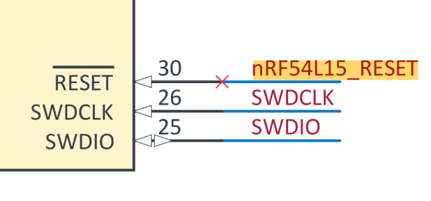

Does the reset of 54L15 need to be handled? Still pull up a 1k resistor. Also, do I need two wires for debugging?

    Reset pin: The nRESET pin on the nRF54L15 has an internal pull-up resistor, so you don't need an external pull-up. You can leave the pin unconnected or route it only to a test pad. If you want extra immunity to noise, which is a reasonable precaution next to the wireless charging coil, keep the nRESET trace short and away from the coil, and optionally add a small capacitor to GND. Note that the capacitor makes the reset pulse a bit longer.
    Two-wire debugging: Yes. Programming and debugging use Serial Wire Debug (SWD), which only needs SWDIO and SWDCLK, plus GND and a VDD reference for the debugger. The debugger can reset the chip, and also erase and recover it, through the debug port, so nRESET doesn't have to be connected to the debug connector.
