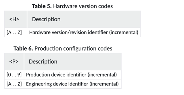

What's the difference between blew two parts (QFAAAB VS QFAAAA)? Thanks.

Since the nRF54LS05B is still in engineering state, there is only a preliminary datasheet available.
This does not include a ordering code and a definition of the markings, so I will have to share the nRF54L15 definition:
The last two characters in the second line, ie QFAAAB / AA in this case, is:
A is the hardware revision, and the next letter; A and B, are indicators of engineering device identifier. This will differ if one device is produced at a different location, for instance.
So: These are both the same hardware revision, but there is a difference in the surroundings of for instance the manufactory location.
