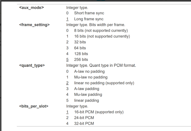

I'm developing a project that would communicate with a cellular module using AT-Commands, and voice data using PCM, these cellular modules are always using PCM Short, and Long Synch frames to send, and receive audio, here I'm using NRF54L15 to interface with the cellular module.
the questions are:
1 - is I2S peripheral compatible with PCM Short, or Long Synch frames. as I've read documentation, and I cannot find that there's configuration that has PCM Short, or Long Synch frames. or is there any hack to make them compatible with each other?
2 - Can I make SPI peripheral communicate with PCM directly or, there's hardware limitations?
    This is not supported directly in nRF54L15.
    I would recommend that you rather look into the nRF54LM20, which has a TDM peripheral:
    https://docs.nordicsemi.com/r/bundle/ps_nrf54lm20a/page/tdm.html
    This can potentially fit your needs.
    Another option is to check with the external module vendor to hear if they support I2S mode on that device.
