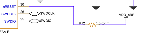

Pls help check schematic diagram
Application: Find my tag
Customer: SHENZHEN FEASYCOM TECH CO LTD
Find my tag.7z
    Feedback 1: C35 should be 2.2 nF on DECRF pin.

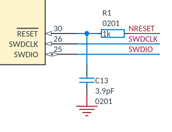

    Feedback 2: Add a 3.9 pF capacitor at nRESET, placed right at the pin, as in the reference. See image below.
    Reference below,

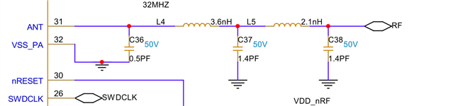

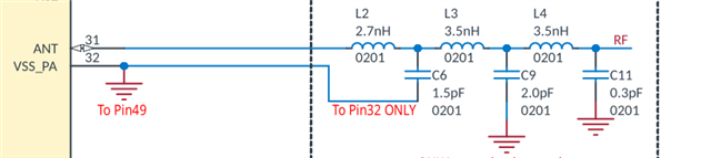

    Feedback 3: The ANT matching network does not match Nordic’s reference. The first series inductor is missing, and the component values differ. Copy the reference as shown below.
    Reference below,
    Feedback 4: Both pin 5 (P1.04) and pin 6 (P1.05) are labelled UARTE20_TXD. One of them must be UARTE20_RXD.
    Feedback 5: The NFC net labels are crossed. Pin 3 (P1.02/NFC1) goes to net NFC2, and pin 4 (P1.03/NFC2) goes to net NFC1.

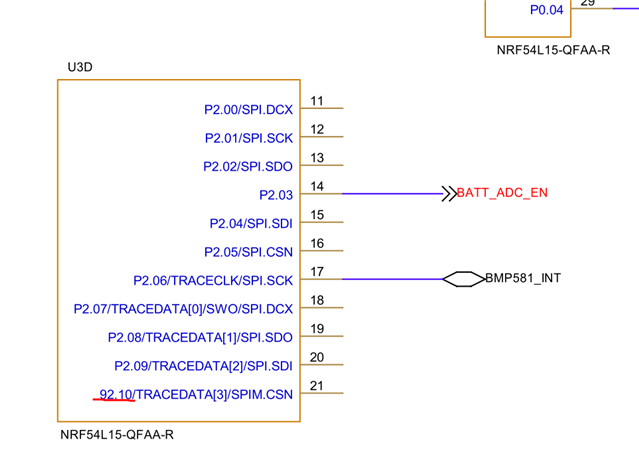

    Feedback 6: Typo on pin 21
    Rest of the schematic looks fine. Make sure the footprint is close to our reference schematic, most important for the ANT network and the supply. If you can send me the datasheet for the crystals, I can check them too.

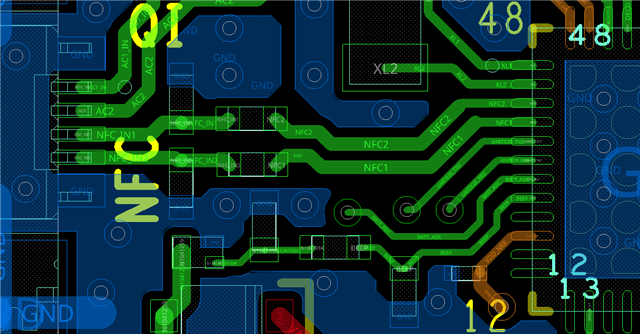

    The R&D  has a question ,  The nfc coil is completely symmetrical. Is there any problem with network switching? Or, what impact will the forward or reverse insertion of the coil have on card reading ?
    Curry.
  • Or perhaps it's just that the online name is reversed, and the performance is not affected.
    The reason for the engineers' crossover is that when laying out the pcb, they found it was not smooth, but after the crossover, it became smooth.
    Curry.
  • Hi again,
    I tested this with the NFC1 and NFC2 connections swapped, and tag reading works the same in both cases. You can keep the crossover as it is. The antenna network is symmetrical, with the same load on both pins.

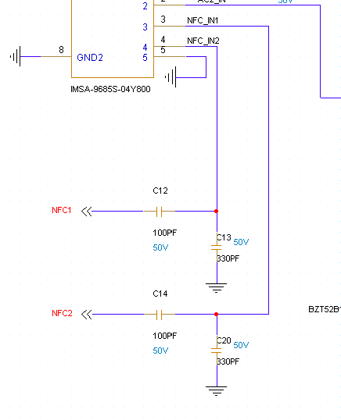

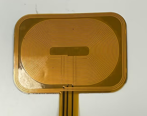

  • I still have one more question that I'd like to consult.
    Our NFC coil and QI coil are integrated together. Similar to the following picture
    To reduce the impact of QI on NFC, I connected a 100pf capacitor in series in the circuit. As shown in the following figure, the NFC1 NFC2 network is connected to the nRF54L15. Connect the NFC_in1 and NFC_in2 coils.
    My NFC and QI don't work simultaneously. I also know that adding 100pF of capacitance will reduce the sensitivity. But this is also a reluctant move.
    I'd like to ask, if capacitors must be connected in series at this place, what size of series connection is appropriate? Or are there any other good ways?
    My QI charging power is very low, not exceeding 1 watt.
    Curry.
    Your placement of the capacitors is correct. They should sit in series between the tuning capacitors and the NFC pins.
    100 pF is also a good choice, since it blocks most of the Qi energy and reduces NFC sensitivity a little. You can also try a smaller value, such as 47 pF, which blocks even more of the Qi energy but reduces NFC sensitivity further. If you change these capacitor values, remember to retune C13 and C20 to 13.56 MHz.
    Could you measure the Qi charging power with the NFC coil disconnected? Could you also try another Qi charger, if possible, to see if the same problem occurs?
