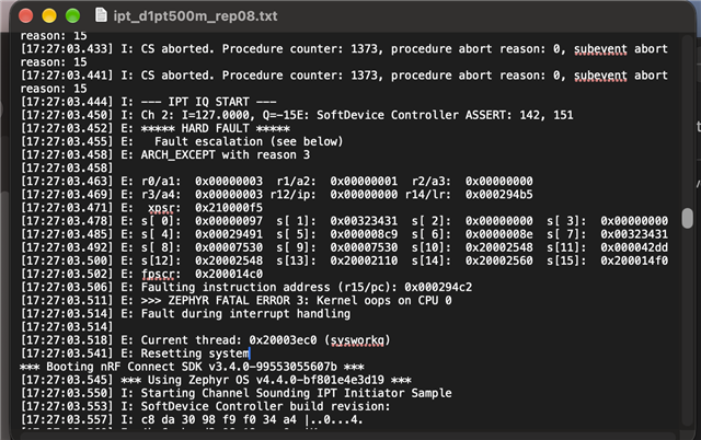

1. CONTROLLER ASSERT 142, 151 FOLLOWED BY A HARD FAULT (IPT ONLY)
On the IPT initiator, the SoftDevice Controller asserts with 142, 151 and the board hard-faults, then resets and resumes. Over about 70 minutes of IPT capture I logged 51 of these faults. Over about 190 minutes of RAS capture I logged none.
I have attached the log screenshot for this question -
I found no public thread with assert 142/151. The closest I found is this - https://devzone.nordicsemi.com/f/nordic-q-a/129033/softdevice-controller-asserts-23-587-and-135-301-under-channel-sounding-load-on-nrf54l15-ncs-v3-4-0
Questions:
(a) What do asserts 142 and 151 mean?
(b) Is this a known issue, and is it fixed in a newer SDC or NCS release?
(c) Is there a recommended workaround? My hypothesis is that heavy UART logging at IPT's faster procedure rate delays controller timing. Does that fit what you know?

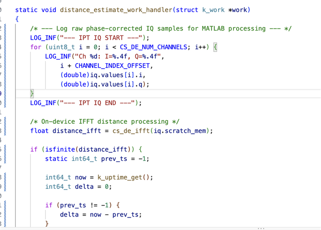

2. Build ipt_initiator and ipt_reflector from NCS v3.4.0 for nrf54l15dk/nrf54l15/cpuapp. Modifications to the samples:
No config file changes were done.
3. Flash both boards and log the initiator's console UART (115200 baud) to a file.
4. Power both boards at a fixed distance. I saw the fault at distances between 0.97 m and 6.58 m.
5. Let it run. The initiator prints one block of ~75 per-channel IQ lines ("--- IPT IQ START ---" ... "--- IPT IQ END ---") followed by a distance estimate roughly every 250 ms. The assert occurs in the middle of the IQ lines, shortly after "CS aborted" messages, then the board hard-faults ("Fault during interrupt handling", thread sysworkq), resets and resumes. In my logs this happened about 0.7 times per minute on average (51 faults in about 70 minutes of capture), so it reproduces within a few minutes.

  • Hi
    1.
    a) The 142, 151 assert points to an assert when updating the length of a Channel Sounding subevent. So it could be the max_procedure_len that times out or the subevent_counter that is invalid.
    b) There are quite a few improvements to our Channel Sounding libraries there. https://github.com/nrfconnect/sdk-nrfxlib/blob/v3.4.1/softdevice_controller/CHANGELOG.rst#bug-fixes
    c) That does not seem to match this assert. Then I'd assume you get a buffer overflow reported somewhere instead.
