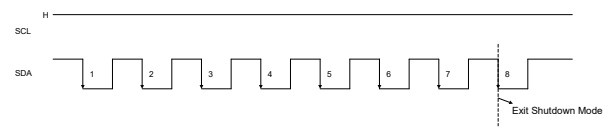

I'm working to write a Zephyr-compatible driver for the LP5814 on a board with a nRF5340. The LP5814 is an LED controller that receives commands over an I2C interface. There's a feature of the LP5814 that is proving to be difficult to implement because of how Zephyr controls access to the I2C bus.
The feature in question is the LP5814's low power mode. Entering it requires a simple I2C transaction, but leaving it involves a special sequence of edges on the SDA and SCL pins that belong to the I2C bus. See the timing diagram:
There's an alternate way to enter and exit low power mode, but it looks like it could be vulnerable to being activated with I2C traffic meant for other devices.
Multiple threads in my application access I2C devices. They go through the usual Zephyr-nrfx glue code, which involves a synchronization object so that only one thread can do a transaction at a time. Unfortunately, there isn't a way to acquire this lock without also enabling the I2C peripheral. It would be desired to acquire the lock while keeping the I2C peripheral disabled so that no other I2C-driven device driver could interrupt the wakeup procedure of the LP5814.

Currently, my work-around is to access the nrfx driver directly so I can shut off the I2C peripheral and reconfigure the pins to my desires, restoring the configurations and reactivating the I2C peripheral when finished. This workaround has to be wrapped in something like a scheduler disable, which feels awful.
