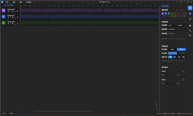

    Issue Details:
    1. In BLE's bidirectional transparent communication with one master and three slaves, transmitting 128 bytes at 25 ms intervals yields a rate of 5.12 KB/s; with a baud rate of 115,200, the maximum communication rate can reach 11.52 KB/s.However, when the bidirectional transparent communication rate between the BLE master and three slave devices is 5.12 KB/s, data loss occurs upon receipt by the BLE master and slaves.
    2. During transparent communication in a BLE master–slave configuration, the pulse waveforms output by the BLE master and slave on the isochronous channel pins may become unsynchronized; for details, please refer to the image below.

  • Hello, and thank you for the translation. It is a little more detailed than my google translate translation Slight smile
    1: It is not entirely clear to me how much data goes in both directions, but let us say that you transmit 128 bytes to 3 devices every 25ms:
    128bytes/message * 8bits/byte * 3 devices * 40 messages/second = 122880 bits per second. And that is without the replies from the peripherals back to the central. Already you are over 115200
    Then, every byte on uart has a stop bit and perhaps a parity bit, so it is really more like 10 bits per byte of actual transfer time.
    Then you have some additional data. There is more UART data than the actual payload bytes between the host and the controller. And there is more packets than just the payload that you want to send. So indeed, 115200 is too slow.
    2: I am not too familiar with this sample yet, but I suspect that you are dealing with some queuing issues, so I suggest we look into issue 1 first. Try increasing the baudrate to 921600, or perhaps even 1000000.
    Regarding BLE throughput, 3 devices with 128 bytes every 40ms should be fine, but to be sure, please tell me more about your connection parameters. What is your connection interval and MTU?
    But with the correct parameters, this is perfectly doable. 128 bytes is only one packet if the MTU is sufficiently high. Also, data loss over BLE is almost impossible. Packets will be retransmitted forever, until it is either ACKed or the connection drops. So if you are loosing data between one end and the other, it is probably over the UART link on one of the sides (probably the central, with most traffic).
    Edvin
