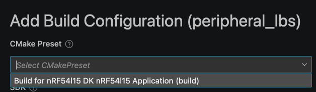

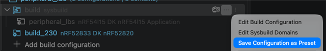

    If your intention is to save and version control build commands, please use cmake presets instead:
    Then you load this when adding a configuration:

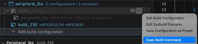

    It does not support 100% of the cmake presets spec. For a foolproof way, save the west command and use it rebuild after switching branches. This will refresh the `build_info.yml` with correct info:
