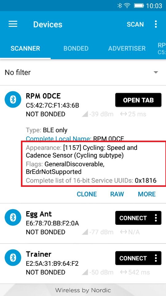

Hi, I use nRF51422 in Dual mode(SD310) with SDK10 Version. The profile is CSCS. I want to ask How to just show Speed Sensor or Cadence Sensor. Here is what I did just show Speed Sensor to Phone side in cscs example code
static void csc_sim_measurement(ble_cscs_meas_t * p_measurement)
    // Calculate simulated wheel revolution values.
    p_measurement->is_wheel_rev_data_present = true;
    p_measurement->cumulative_wheel_revs  = 100;
    p_measurement->last_wheel_event_time  = 100;
    // Calculate simulated cadence values.
    p_measurement->is_crank_rev_data_present = false;
    p_measurement->cumulative_crank_revs     = 0;
    p_measurement->last_crank_event_time     = 0;
    uint32_t              err_code;
    ble_cscs_init_t       cscs_init;
    ble_bas_init_t        bas_init;
    ble_dis_init_t        dis_init;
    ble_sensor_location_t sensor_location;
    // Initialize Cycling Speed and Cadence Service.
    memset(&cscs_init, 0, sizeof(cscs_init));
    cscs_init.evt_handler = NULL;
    cscs_init.feature     = BLE_CSCS_FEATURE_WHEEL_REV_BIT | BLE_CSCS_FEATURE_CRANK_REV_BIT |BLE_CSCS_FEATURE_MULTIPLE_SENSORS_BIT;
    cscs_init.feature     = BLE_CSCS_FEATURE_WHEEL_REV_BIT;
    err_code = sd_ble_gap_appearance_set(BLE_APPEARANCE_CYCLING_SPEED_SENSOR);
I use Phone App "Wahoo" to add this device still show up this is CYCLING_SPEED_AND_CADENCE not just Speed Sensor.
So what can I do. Thanks.
