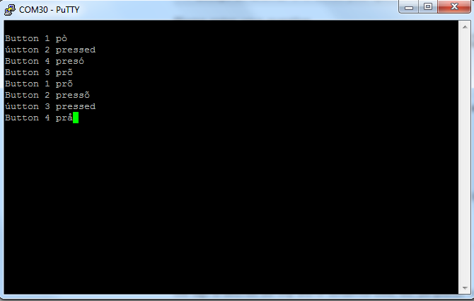

Putty does not recieve the same as nRF52DK sends over UART
I want to send over Uart when Button1,Button2, Button3 and Button4 are pressed.
static void button1_pressed(void)
  printf("\r\nButton 1 pressed\r\n");	//Turn on
But on the putty I will not recieve the hole message. And its always different what I recieve:
image description
I checked the Baudrate. And for both(Putty and DK) it is 9600 Baud.
What else can be the reason for this occurence?
Problem is solved if I change the Baudrate to 4800. But 9600 isnt really fast. I will need faster Baudrate for other application....
How can I use faster Baudrate without loosing characters of the message?
