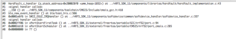

Question 1) Any ideas why in the SoftDevice event handler (ble_new_event_handler() copied straight form the SDK11 example ble_app_hrs_freeertos) fails with a stack trace like this:
HardFault_handler () ... gcc_startup_nrf52.s
<signal_handler called>
0x000092a in ?? ()
... in vPortStartFirstTask()
Otherwise this looks good to me but should have exited the previous signal handler before the new one gets called. This stack trace is (manually) copied probably from a test running the signal handled event task on the lowest FreeRTOS priority.
If using a high FreeRTOS task priority, then the same error happens at portYIELD_FROM_ISR(yield_req) in the ble_new_event_handler(). Specificly the hard fault happens in portmacro_cmsis.h at the end of the portYIELD() call at the __ISB(); line.
Our application logic can manage with omitting the portYIELD_FROM_ISR() call in ble_new_event_handler() and that seems to fix the instability. This is not optimal.
