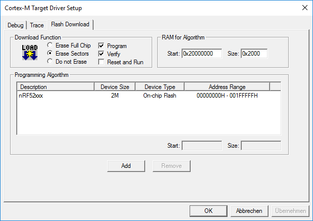

Hey togehter,
has anyone succeeded setting up a connection between ST-Link and nRF52832? I connected the pins (GND, SWDIO, SWCLK and second try with GND, SWDIO, SWCLK,VTREF,RESET), but Keil as well as the ST-LINK_CLI tell me that no device is available.
image description
For reference, the ST-LINK and nRF51 seems to work:
devzone.nordicsemi.com/.../ devzone.nordicsemi.com/.../
Thanks!
  • Hello Greg, it's running now with the connection mentioned in my comment from Aug 4' :
    ST-LINK:GND -> nRF52:GND
    ST-LINK:T_JTCK -> nRF52:SWCLK
    ST-LINK:T_JTMS -> nRF52:SWIO
    ST-LINK:T_NRST -> nRF52:RESET
    ST-LINK:T_SWO -> nRF52:Notconnected
    The final point was now, that there was not enough RAM reserved for the programming algorithm by default. I updated the RAM size, and it's running.
    Thank you for your support!
    BR Hauser
