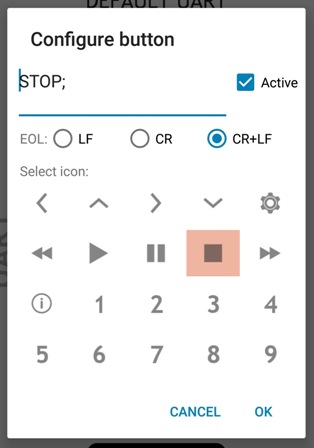

  • Here is the trick to add " in the "nRF Toolbox" UART application for smartphones:
    1. First - the Configure button text fields for editing the button data in the nRF toolbox app are multiline! Just press enter in the text field to make as many + pairs you like.
    2. Secondly the EOL option [LF, CR, CR+LF] in the UART Configure button dialog act as a FILTER. For the filter option to work you first HAVE to add linebreaks to the text field.
    Not so intuitive - as you may first think the UART app button command option selects what characters to append.
    nRF Toolbox nRF Toolbox - UART - button command editor
    The second image displays a linebreak added in one of the the UART, Configure button text fields.
