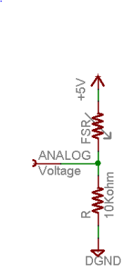

I am trying to move an arduino project where I read an ADC value from a FSR sensor. In arduino the FSR is powered by 5V and has 10Kohm pulldown resistor. The board is currently connected using the USB cable and will remain that way
image description When I've looked at the ADC examples, SDK documentation and forums I have seen that

  • I will close my own ticket.
    Considerations:
    A) Check damaged PINs? Directly connect the PIN to GND and the value will be 0 or 1 in your ADC program
    B) Prescale happens internally before entering the ADC conversor so if you have 3V signal and prescale of 1/3 then you get 1V at the ADC conversor (in Section 31 is explained very good)
    C) You CAN'T Have a voltage higher than 2.4V after prescaling so if I use 3V as input source I need to prescale either with 1/3 or 2/3 ... 3V * 1/3 = 1V or 3V *2/3 = 2V
    Another important thing is that the pin itself has a limitation on the voltage (VDD + 0.3V). So the max voltage supported is 3.6V and you will need a voltage divider if your voltage is higher.
