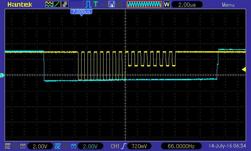

There are 2 issues that I am having when issuing a read of peripheral register 0x0F (using cmd 0x8F):
  1. Response data printed within the callback should always be 0x33 (the fixed value in register 0x0F), but is often erroneous.
  2. Voltage levels on the clock, MISO and MOSI lines look incorrect during peripheral responses.
Relating to "1." - I repeatably read a register value of 0xFF and then the correct 0x33 (and then 0xFF again and the cycle repeats) when using the fastest Nordic SPI rate of 8 Mbps. At lower rates, inconsistent register values are read.
Relating to "2." (which may be the cause of "1."), I believe that there may be contention on the lines as indicated in scope caps.
Please ignore the apparent offset from ground as there is an outstanding scope setup issue.
In this first capture, the yellow line shows my clock and the blue line shows chip select. It is driven low by the Nordic SPI driver as required. image description TagSPI_6.bmp

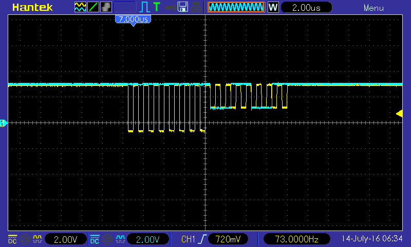

In this second capture, the blue line now shows the MOSI signal. It seems good until a response comes in from the peripheral and then it is driven to a strange state instead of O Vdc. The command is 0x8F (10001111) denoting read from register 0x0F. image descriptionTagSPI_7.bmp

Could this indicate contention on the clock and MISO lines - only when the peripheral is responding to a read command over MOSI? The driver init seems to leave the MISO pin floating.

  • Last time I had levels doing something silly like that I had a grounding issue, are you sure your dev board and your sensor have the same VDD and their grounds connected directly and firmly together? When I didn't have that right, the whole sensor chip floated up and down as GPIOs went high and low.
    You should also fix your outstanding scope setup issue because it makes the results at least a little suspect.

  • "there appears to be contention on the MISO, MOSI and Clock lines." is really totally meaningless, it just doesn't say anything beyond "I don't understand the signals". The peripheral just doesn't produce signals with 1/2 voltages so either there's a connection issue on the board, and it would have to be a very odd one, or the scope's not showing the signal properly. The SPI module doesn't produce signals which look like that, whatever you do to it.
    As to the rest, since SPI clocks data in at the same time it clocks data out, throwing away the first few received bytes is not unusual because the first few bytes are clocked in from the slave before it's received the bytes with the request, and those bytes are often either 0xFF or 0x00, ie with no data to send the slave just clocks out 1s or 0s. So that sounds completely usual to me.

  • Thanks Daniel. The reception of the leading 0xFF is clear to me now. The strange scope signals remain a mystery and are most likely just an issue with the scope or my setup of it (I am a software guy who hasn't used one for a few decades). I will get a hardware engineer more involved in an effort to resolve.
