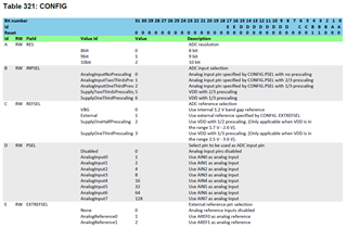

Is there a way to measure external battery voltage (connected to NRF51822) internally using S110 .

Guys Got solution form this link
[https://devzone.nordicsemi.com/question/43647/how-do-i-measure-battery-level-on-an-nrf51422-without-external-components/]

The link does not exist anymore.
It is detailed in the nRF51 Series Reference Manual page 169. There are two choices for internal measurement of VDD.
