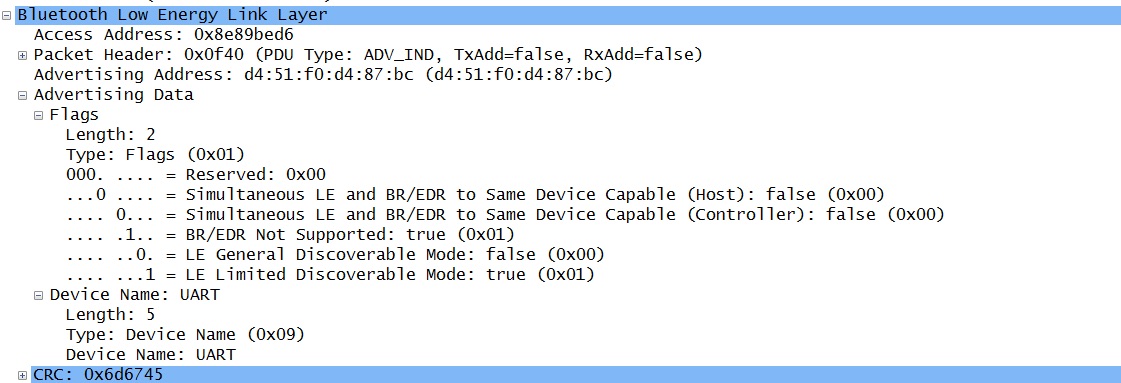

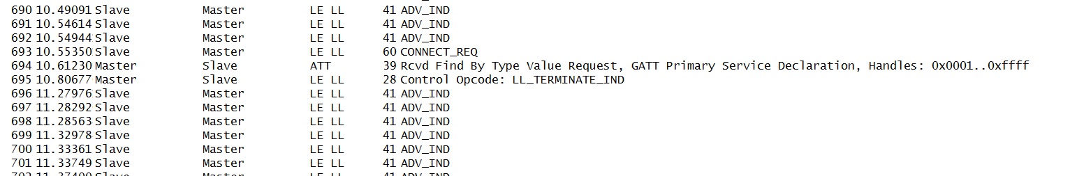

nrf51connect.pcapngnrf52disconnect.pcapngHi i m using pi3 with bluez and the gatttool i can easy connect to the Adafruit Feather M0 with a nrf51 as bluetooth module but when i try to connect to the nrf52 developer kit it dosen t work! I can connect the nrf52 to the iPad using the nordic app! I m planning to use the Uart uuid! Where is the difference?
Update: No i can connect but it disconnect after about 30sec! I add the logs! the nrf51 version is the code from adafruit so i don't now which soft device they are using! We are using the S132 which is in the log nrf52 it disconnect now after about 30sec!
I don't now why! thank you for responding!
Update: I m using the SDK11 and the uart example! Every example works so far but after 30sec there is a disconnect!
Update: Sorry for the late update! With the Uart Example i can connect to the Device and stay connected! sudo gatttool -i hci1 -b -t random -l low --interactive If im trying to use the S132 with the BLE Device Manager it will Disconnect after 30sec! Is it possible to detect why the Device disconnect? (Time out or error??)
