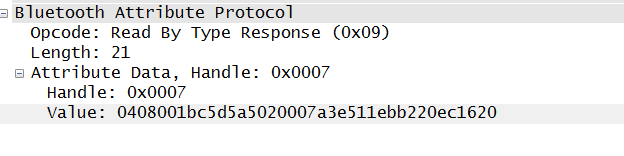

I'm trying to discovery the content of a vendor specific GATT service. So far I'm receiving the BLE_DB_DISCOVERY_COMPLETE event and I'm able to see that I got 4 entries. All characteristics have a different UUID (in more bytes, not only 12/13).

Each characteristic seem to have a proper handle for the declaration and value. On the other hand, the uuid struct is showing only zeros in both, type & uuid. The CCCD handle is also set to 0. In the sniffer I see the Response to the "Read by type" request, with the 'valid' UUID content.
image description
There is something 'special' to be performed in case of a discover over 'different' UUIDs ?
