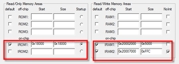

    3.Last question is how to set application project IRAM and IROM? image description
  • @temco_heng (hengyongchao): Please post this as a separate question and provide a link to the new question in the comment section of my answer above.
