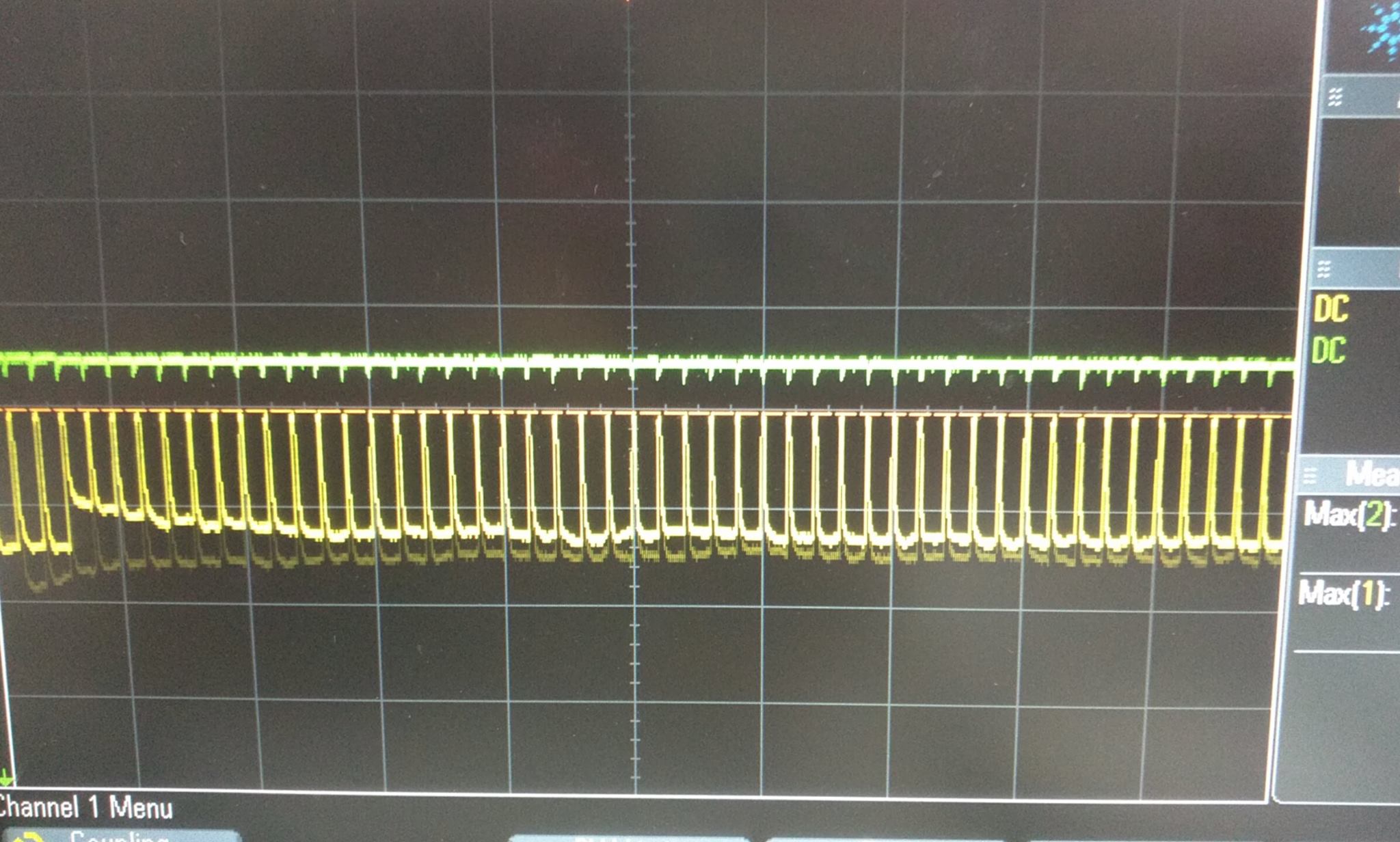

I have a nrf52-DK, I made samples with the saadc unit and i noticed there are unexplained peaks. I connected the MIC's output (its VDD is from the board) to an oscilloscope and saw the peaks occurs when the vdd(provided from a usb cable) has minor fallings.
The circuit is in the picture below: image description
Here the green graph is Vdd, and is measured 2.97[V], the yellow graph is the microphone's output. image description

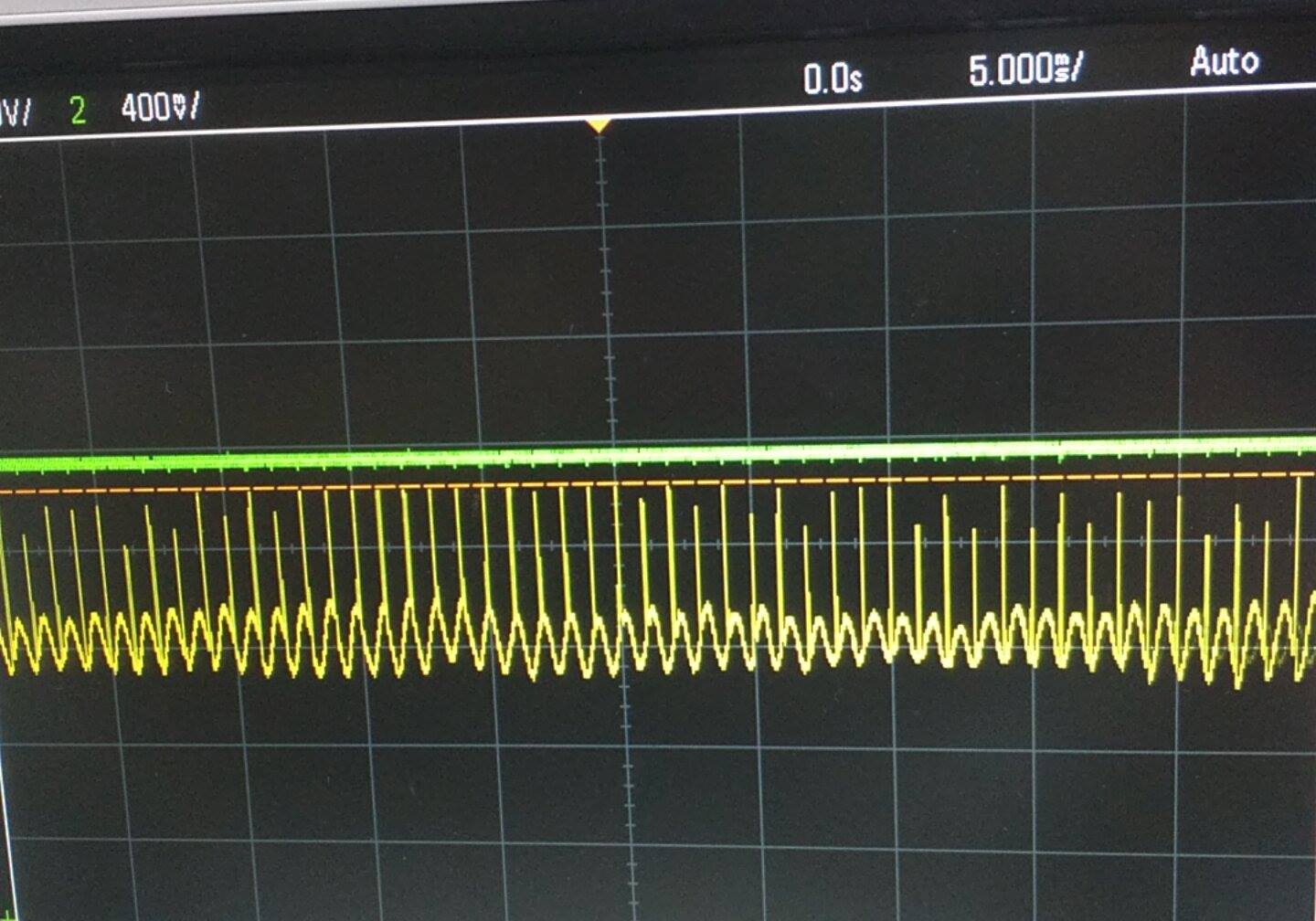

I then connected the MIC to a power generator and with the same input voltage the signal was clear. When i made the coin battary to power the board the voltages in the scope had bigger falldowns, and the MIC's output is worse: image description and after a few second suddenly everything clears out and everything is good: image description
Why from a usb it doesn't happen? What can cause this problem?
