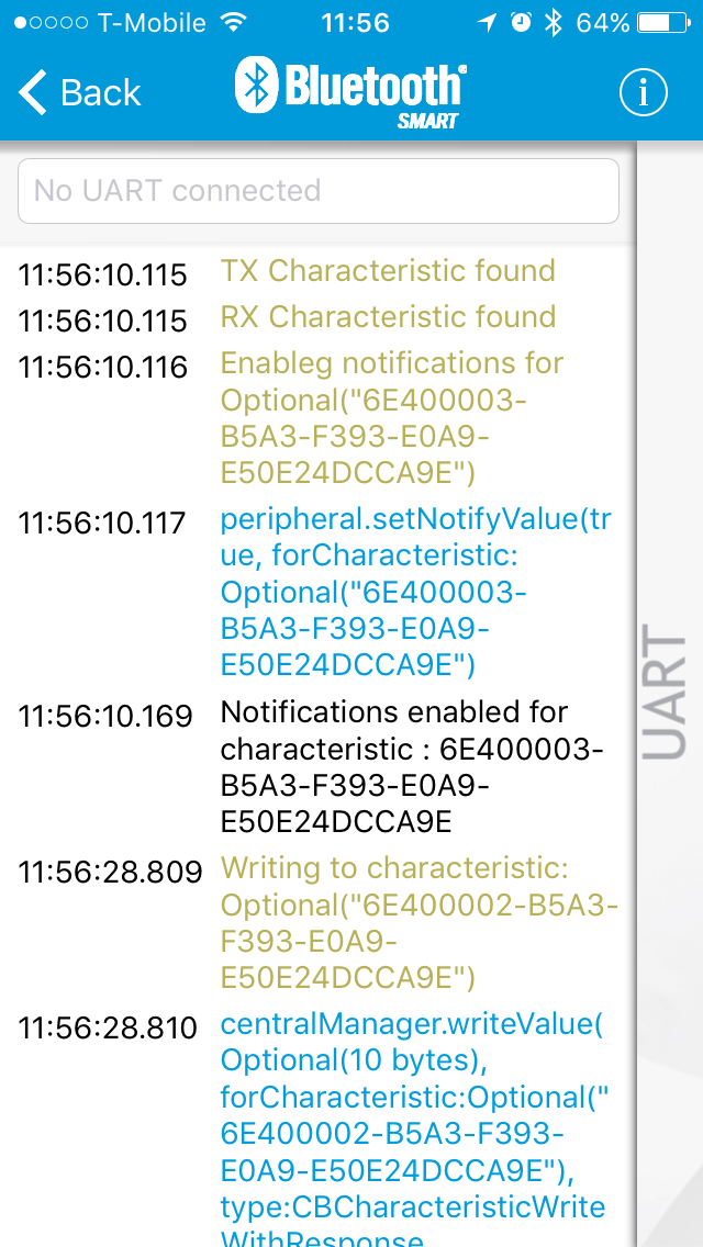

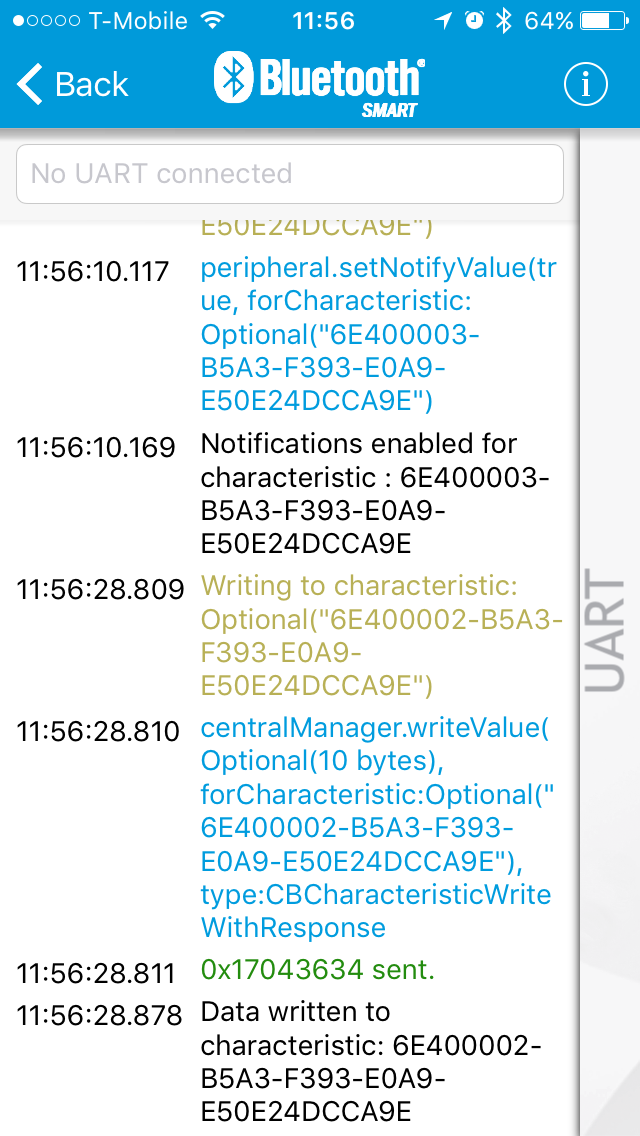

After upgrading to iOS 10, I have been unable to successfully interact with my device using the NUS. I used to use the NUS to communication with the device and retrieve stats. For example, I would send a "T" message to the device and it would respond with some information on the temperature of a couple of thermistors.
Now when I try to send a "T" this is all I see: image description image description image description

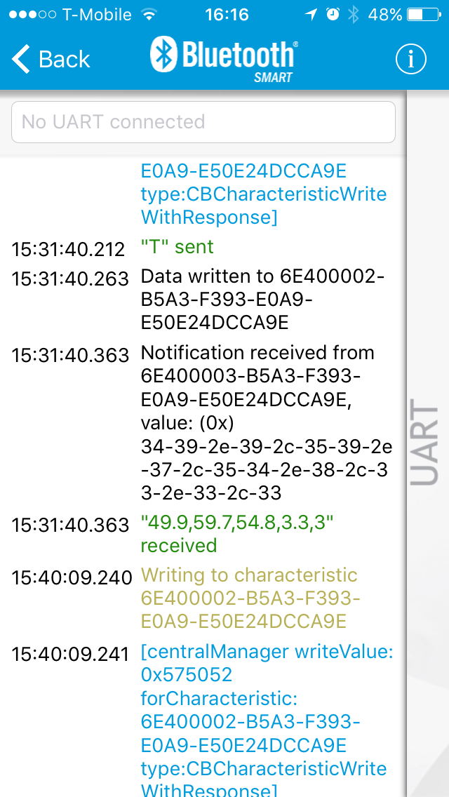

Before it used to also show the message that was sent. Now it doesn't show that a message was sent. The following image is taken from two months ago. This is the behavior that I can no longer reproduce but would like to see. image description
Also, I have noticed the appearance of Optional("...") in interactions since the upgrade. For example, in the first image it first says 'Connecting to: Nordic_UART ...' but then it later says 'Connected to : Optional("Nordic_UART")'. Why has this appeared?
