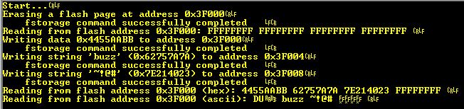

Update 2 26.10.2016 I attach another SDK 11.0.0 example with the following UART output
ble_app_template_with_fstorage_operations_ascii.zip
