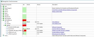

I have the same problem. Ich start exampe (BLE Multi-link Example with PCA10028A) in SDK 12.3.0 and want SD S130 v.2.0.1. But I can't install SD v2.0.1. There ist only SD v2.0.0-alpha to use.
How can I add SD 2.0.1 in Manage Run-Time Environment?

I did that. I have downloaded the SDK 12.3.0 and installed it and started the exampe in it, but the SD is 1.0.2. used.
1. Why was not the current SD, ie S130 v2.0.1 used?
2. Why is there only SD 2.0.0-alpha after installation, instead of 2.0.1?
(C: \ Keil_v5 \ ARM \ PACK \ Nordic Semiconductor \ nRF_SoftDevice_S130 \ 2.0.0-7.alpha \)
I expected the example in SDK 12.3.0 to use the current SD.
Best regards
Oat
It does use the latest version (s130 v2.0.1). Just ignore what shows in your "Manage Run-Time Environment" tab and flash the softdevice as described in the getting started documentation. The "Manage Run-Time Environment" configuration is not valid for non-packs version of the SDK.

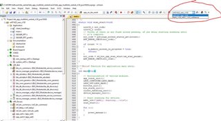

Ok, I'm ignoring the shows in run-time, but it worked only with s130_nrf51_1.0.0_softdevice.hex, not s130_nrf51_2.0.1_softdevice.hex.
That is not a SDK 12.3.0 project you have open. You need to open the project from inside the SDK 12.3.0 directory, as descibed in the getting started documentation.
Hi Jørgen,
I've seen my problem, I've copped the example with Pack Installer, so an old revision is being used instead of new.
