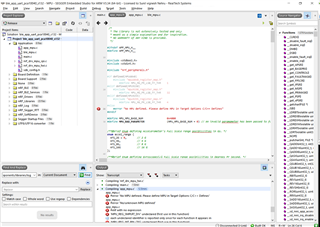

  • HI,
    I am using same github library. instead of keil i want to work in segger. but there is no SES file for the MPU library is there any SES file available..?
    and also i am trying to alternate  " ble_app_uart_pca10040_s132 "   segger solution to work in this MPU library which is SDK 15.2.
    for that i also got the error  #error "No MPU defined. Please define MPU in Target Options C/C++ Defines"

    the respective screen shot
  • Hi Sunil! I don't know if you already solved the problem, but I also use Segger for nrf chip with MPU6050. Go to Project-> Options, then change Debug to Common on the upper left corner, then go to -> Preprocessor-> Preprocessor Definitions and add there MPU60x0
