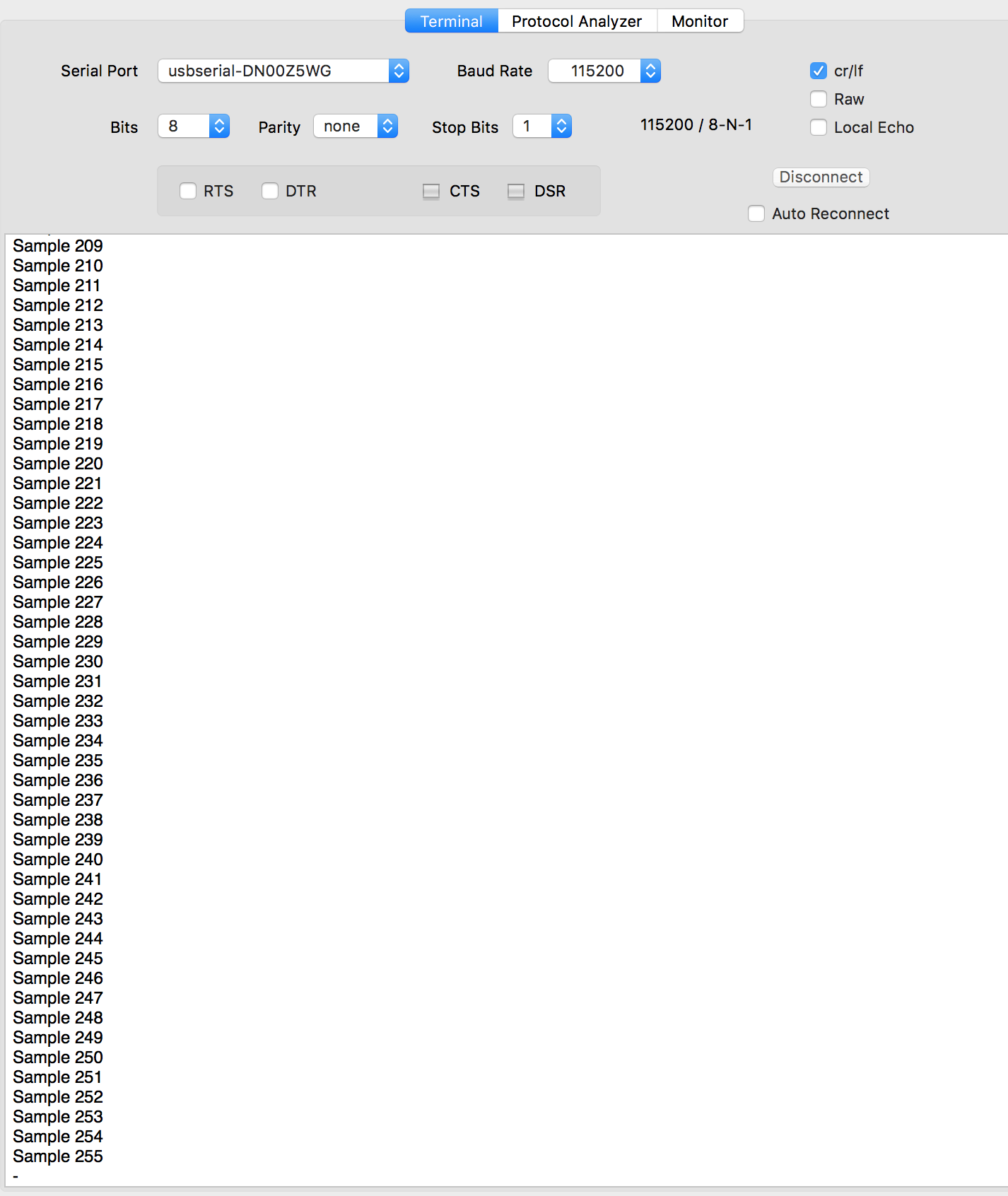

I have very pesky bug that is leaving me in fits. I have a feeling it is a timing issue, but I am not sure at this point. Here is my issue, and I would love anyone's debugging help:
I have helper functions to write chars over UART (I am using a FTDI board to make serial connection to my mac). I am using Rev 1 NRF52 chip with UART configured as 115200baud, IRQ low priority, and flow control off.

The failure occurs when trying to write the first char of the "uart_println("--PSD Start--");" statement (the actual failure is at err_code = app_uart_put(str[i]); in the uart_print method above). It immediately fails with this error in my gdb terminal:
Program received signal SIGTRAP, Trace/breakpoint trap. 0x000008e4 in ?? ()
This is baffling me since the first condition uart_println(test_str); works fine, and if I remove the uart_println statement entirely the function behaves normally. Does anybody have any suggestions on how I should debug or try a different approach. For instance, could this be solved with flow control?
Thank you for the time and help. Josh
Below is snapshot of the Serial output image description
  • As an update I think I am hitting a seg fault since the chip keeps resetting, and faulting at the same place each time. The SIGTrap is a red herring I think since the debugger stops at the program entry point again on reset (I think). When the firmware runs without gdb, I see the crashing and resetting behavior in a loop. Now to find where the memory is getting corrupted...

  • I guess one modification you needed in your code was this, not sure if this was your actual problem. It was skipping few character for me.
     void uart_print(char *str){
        int i = 0;
        while (str[i] != '\0'){
            while(app_uart_put(str[i])!= NRF_SUCCESS);
            i++;
    void uart_println(char *str){
        uart_print(str);
        while(app_uart_put('\n')!= NRF_SUCCESS);
    The 'app_uart_put' function needs to wait before the previous characters which you have already put are sent, Hence the while loop. Hope this will help others.
