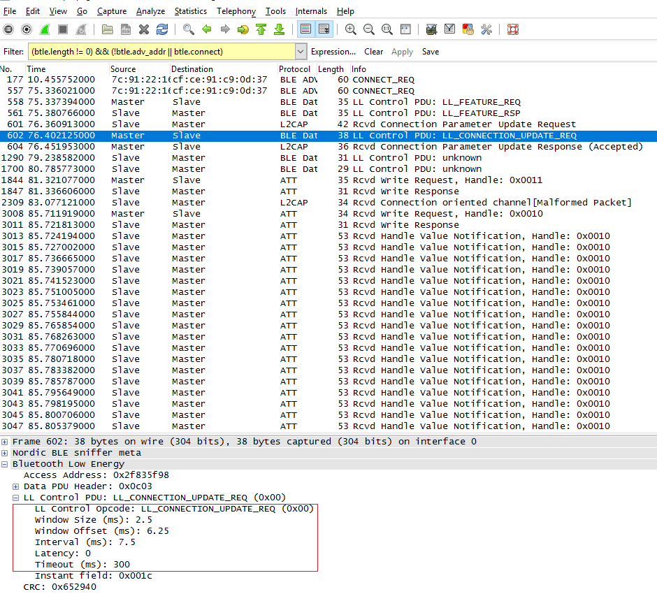

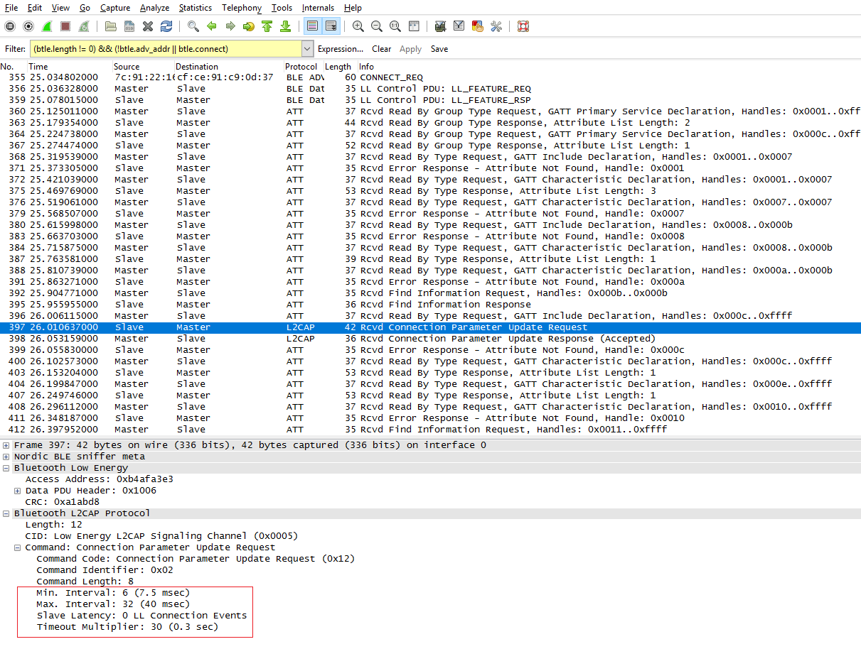

So i ran some tests today and this is what i get. When i connect with my phone i see that connection parameters are as follows: initphoneparams.png. When i use MIN_CONN_INTERVAL MSEC_TO_UNITS(7.5, UNIT_1_25_MS) and MAX_CONN_INTERVAL MSEC_TO_UNITS(40, UNIT_1_25_MS) i can see connection params update request after connection has been actually established: paramsupdate2.png. If i force both MIN_CONN_INTERVAL and MAX_CONN_INTERVAL to MSEC_TO_UNITS(7.5, UNIT_1_25_MS), i am also seeing conn params update request after establishing the connect: paramsupdate1.png.
Both ways you can see that i get connection parameters update response accepted (one packet below than the one i am looking to the data).So i can be sure that my device did update connection parameters, correct?
No for the question that i had to check? Is there a way to see in the software how much packets does actually my peripheral send in one connection interval? Or i just have to look at the times that packets are received and calculate how many packets was send in a certain time? Because looking at the times i would say that when both min and max connection interval is set to 7.5ms i am seeing 2 - 3 packets in one connection event, but that number is not consistent. I also see a packet loss. If i set min connection interval to 7.5ms and maximum connection interval to 40ms, i am seeing 2 packets per connection event. Could you watch through my wireshark logs and confirm that what i am seeing is correct?
So am i really seeing the limitations of my central device here? I also want to ask, if i set min connection interval to 7.5ms and maximum connection interval to 40ms, does that really guarantee maximum throughput for every central?
And also what will happen if i set both connection interval to 7.5ms and maximum connection interval to 7.5ms on my peripheral, but my central does not support this value? Will peripheral just drop the connection? And here are my wireshark logos. max40min75.pcapng and max75min75.pcapng.
Sorry for bad naming also, but the first one is with max conn interval 40ms and min conn interval 7.5ms. Second one is with both min and max conn interval equal to 7.5ms

  • Thank you Hung Bui for your help. I didn't even know actually that there is such a good tool to sniff out BLE protocol :) Everything is clear now. I know now everything and even even more than i wanted to know when asked this question initially. I would convert one of your comments to an answer and would mark it as answered, but i am not allowed to do this under this answer. Maybe you can do it? If yes, please do it.Thank you for your help once again :)
