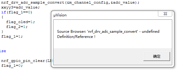

I think there are none error,but always error?
image description
image description
image description
image description

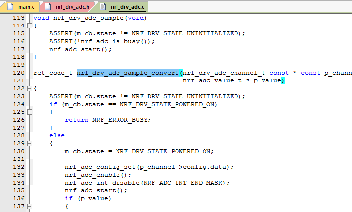

I add the .c and .h file, but always error? Why?
  • Hi ligang,
    You need to enable the ADC in sdk_config.h
    There are two way to enable ADC on Keil
    1. Change the code directly
    2. Check checkbox in configuration wizard
    For No.1 you need to modify the code in sdk_config.h as below
    // <e> ADC_ENABLED - nrf_drv_adc - Driver for ADC peripheral (nRF51)
    #ifndef ADC_ENABLED
    #define ADC_ENABLED 1
    For No.2 Select "Configuration wizard tab" after select sdk_config.h See below picture it is better way for understanding. image description
