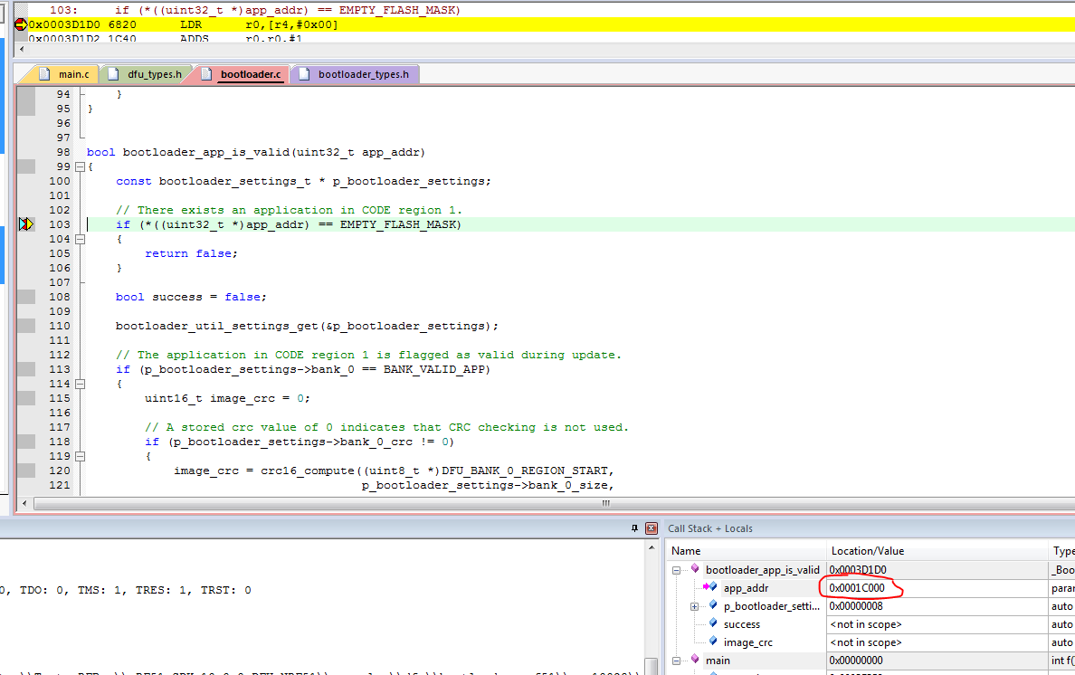

The application is placed at 0x1C000 and it is exactly where the boot-loader expects it to be:

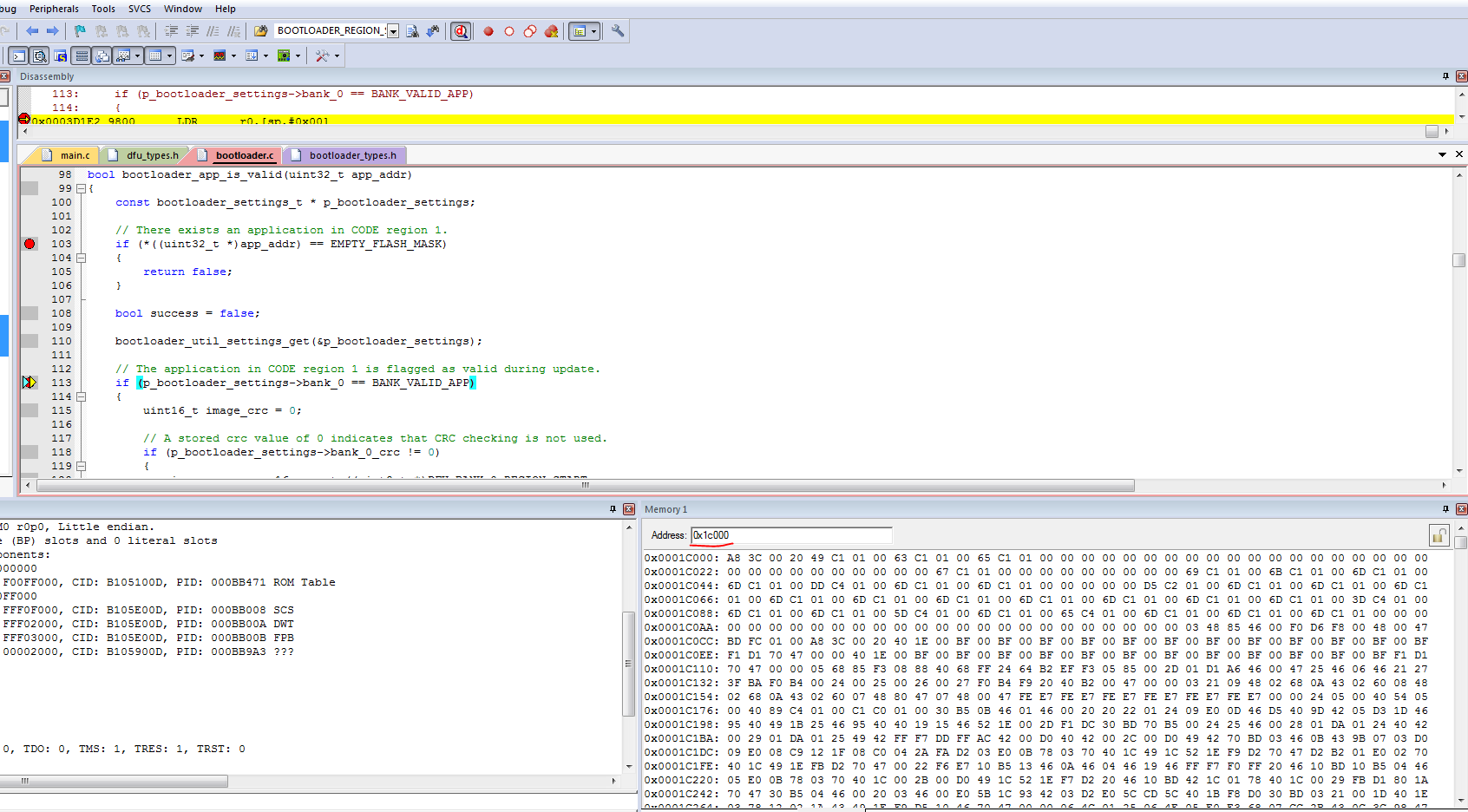

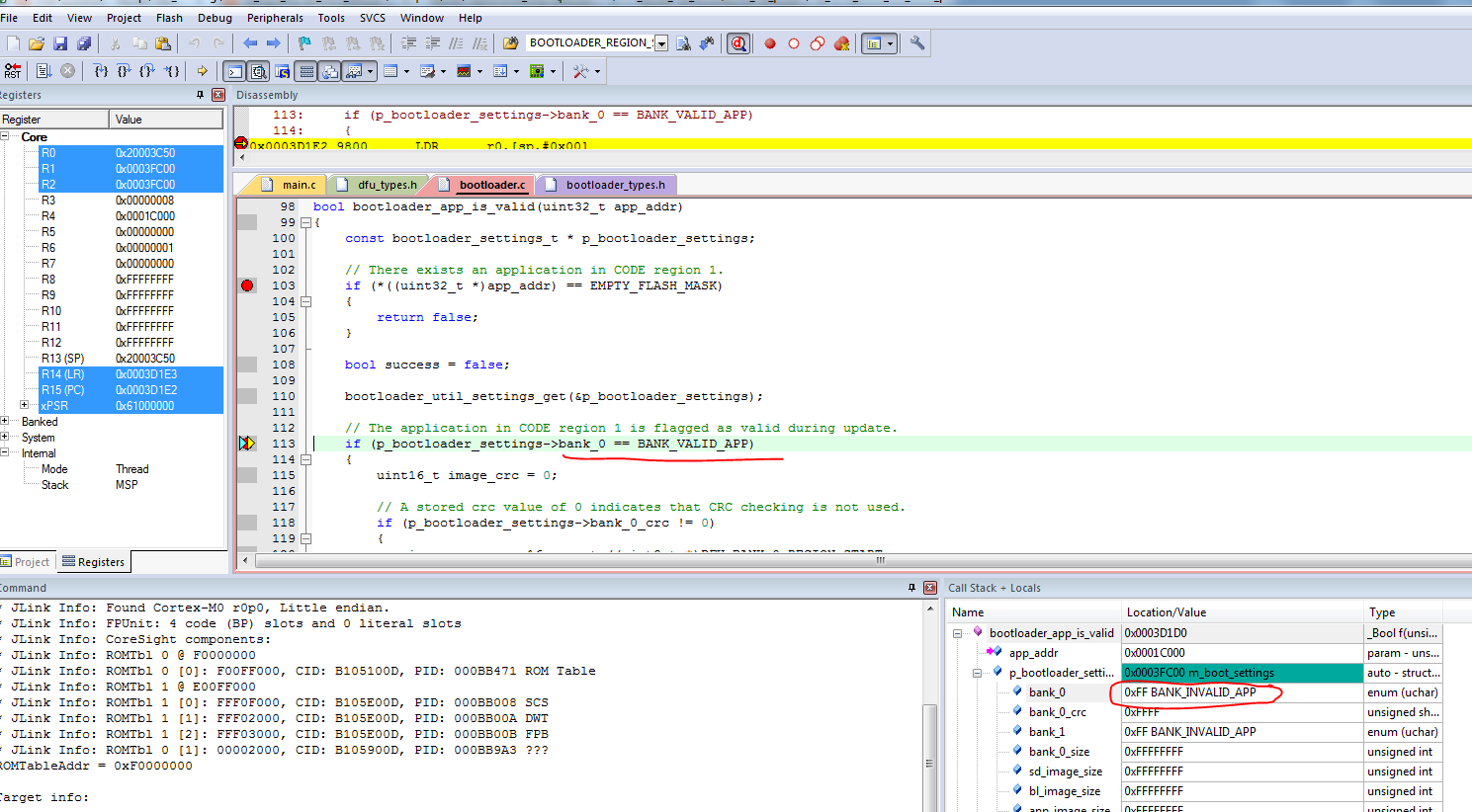

However when checking bootloader_settings->bank_0 flag, no valid application seems to be present:

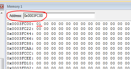

Please note that the app is already flashed via J-Link:image description

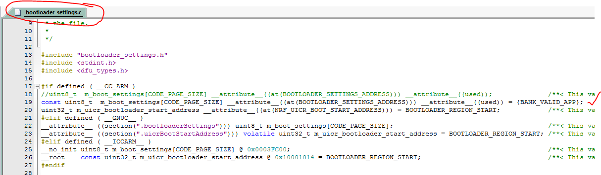

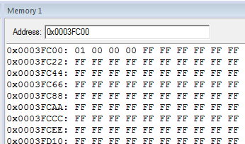

  • If you have erased the chip completely and flash everything, then you have to manually write VALID_APP after flashing. It could be done writing to bootloader settings using J-Link/nrfjprog or you can add it as a default bootloader setting in your firmware as
    const uint8_t m_boot_settings[CODE_PAGE_SIZE] attribute((at(BOOTLOADER_SETTINGS_ADDRESS))) attribute((used)) = {BANK_VALID_APP};.
    Have a look at this for more info.
    If you flash only the firmware (bootloader and softdevice flashed separately) with --sectorerase, then bootloader setting will not be erased.
    For example my bootloader settings are at 0x3fc00 and i do nrfjprog --memwr 0x3fc00 --val 0x01 -f NRF51 to booloader settings to have VALID_APP flag, if i have erased whole chip and flashed everything fresh.
