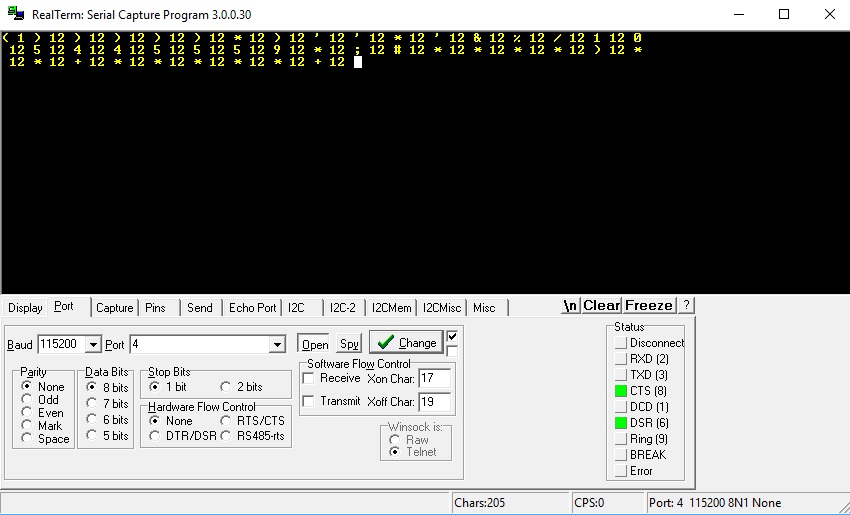

I am using ESB library for nRF52 microcontroller. At receiver i want to measure RSSI value of a packet. I got RRSI from nrf_esb_payload_t structure.
I am printing RSSI value in UART but i am getting some random symboals not proper RSSI values.
Please help me out.

    What kind of values do you read from the RSSI measurements? Does the baudrate in your firmware match the baudrate in the terminal?
  • I modified ESB library. I removed all the configuration and I made it like only when Tx is transmitting then Rx is receiving(There is no Buttons, ACK etc).
    Moreover, I am getting a different kind of ASCII symbols (I removed Typecasting with char) even though am getting ASCII chars and sometimes numbers that 1, 2 etc.
    I have attached my code with above. Please check once.
    I am attaching my Pic which showing 12 as Received data and remaining symbols are RSSI values randomly getting by varying Tx at different positions.

    What happens if you choose to only see the hex values in the "display" tab? The various symbols could be the translated value from hex to ascii.
    If assuming that the "12"s are some kind of overhead, the RSSI values would be the following: -60, -62, -62, -62, -62, -62, -42, -39, -39, -42, etc
