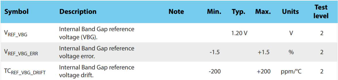

From chapter 8.12 - Analog to Digital Converter (ADC) specifications in nRF51822 Product Specification v3.3, the internal reference voltage is specified:
You can also have a look at this answer.
