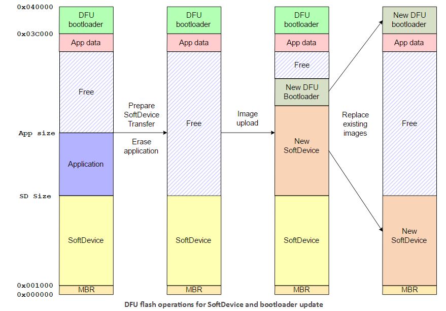

yes,In the single bank mode,when dfu update application start,the old application erased,like dual bank update bootloader and Softdevice,Why can't use single bank update bootloader and Softdevice?
You cannot erase the old SoftDevice before you have received the new SoftDevice image since you're using the old SoftDevice to receive the new SoftDevice over BLE. The bootloader performs the switch and controls the DFU process so that cannot be erased before the new images have been received.
As the figure above,single bank updata application like this ,Just less replace existing images,Why can't use for update bootloader and Softdevice?
You can use a single bank bootloader to update bootloader and SoftDevice as well as application updates.
