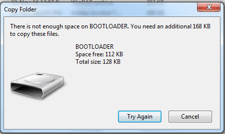

I am trying to update new firmware in nRF51-DK.
But unfortunately, wrong image file is uploaded.
Now i am trying to once again same process then getting no space available error.

Could you give some more information about you updating the firmware ? Was it the firmware on the nRF51 chip or it's the firmware on the interface chip of the board ? Which SDK you are using ? Please add a screenshot when "No space available error" appear.

We are using SDK v12.0.1 or firmware directly on nRF51 chip.
Please let me know what did you do to get to this error ? Which guide you are following ?
The image you attached shows that you are downloading firmware for the Segger chip, not the nRF51 chip. If you planning to download segger chip firmware, you should use the firmware nRF5x-OB-JLink-IF that you can find here.

problem has been resolved by nRF5x-OB-Jlink-IF.
