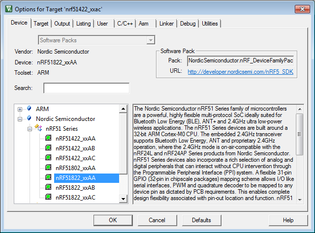

What's the correct settings for nRF51822 CEAAE0 (0x0079) with dfu example in SDK v11 ? I believe the chip I am using is a 16KB ram 256KB rom version, but not sure 51422 or 51822 as the manufacture did a LGA soc which integrated crystals and other dc-dc circuts inside.
I am using the example in nRF5_SDK_11.0.0_89a8197\examples\dfu\bootloader\pca10028\dual_bank_serial_s130
My environment is set to use uvision5. I tried to modify the settings as below:
  1. Device tab, the device chosen nRF51822_xxAA

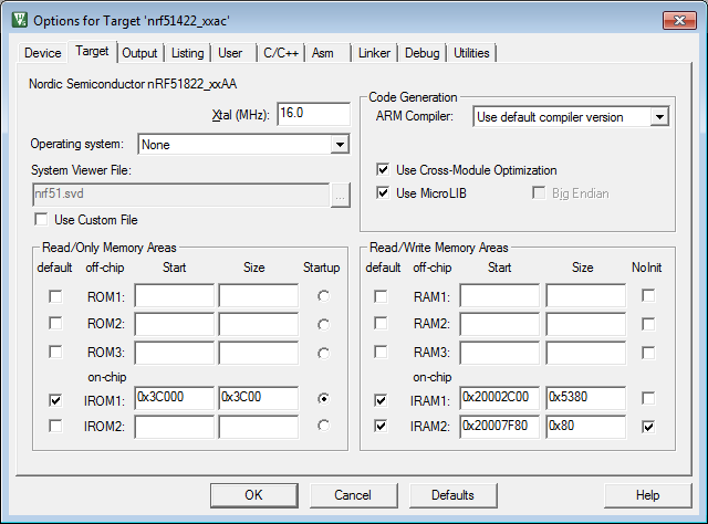

  2. Target tab, Xtal 16.0MHz [yes] IROM1 0x3C000 0x3C00 (yes) [yes] IRAM1 0x20002C00 0x1380 [no] [yes] IRAM2 0x20003F80 0x80 [yes]
I am sure the dfu bootloader is working on nRF51-DK
  • Yes, the nRF51822 CEAAE0 has 256kB Flash and 16 kB RAM, so the only change you should have to do is to modify the RAM1 and RAM 2 size in the bootloader example, i.e.

  • If this configuration works, then it means that you must have a 32kB RAM variant of the Insight. However, you should be able to run the bootloader with the 16kB RAM configuration on a 32kB RAM, but not vice versa of course :)
