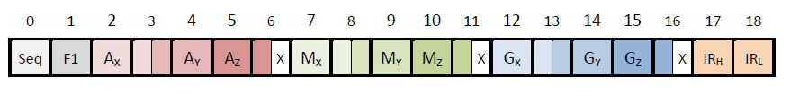

I have platform base on nrf51822, collecting data through I2C and sending to android application. the device is working according following protocol: Motion data is sent twenty times per second and ambient data once per second. Motion data packet has the following format, each bigger box representing a single byte (eight bits), and smaller box representing a half byte (four bits):
Where: Seq is message sequence number F1 (hex) is a fixed constant identifying the data content AX is accelerometer X value, 12 bits AY is accelerometer Y value, 12 bits AZ is accelerometer Z value, 12 bits MX is magnetometer X value, 12 bits MY is magnetometer Y value, 12 bits MZ is magnetometer Z value, 12bits GX is gyroscope X value, 12 bits GY is gyroscope Y value, 12 bits GZ is gyroscope Z value, 12 bits IRH and IRL are infrared sensor’s temperature high and low bytes correspondingly All “X”s are don’t care half-bytes. Ambient data has the following format:
Where: BH and BL are air pressure high and low bytes correspondingly BTH and BTL are air pressure sensor’s temperature high and low bytes correspondingly HH and HL are air humidity’s high and low bytes correspondingly HTH and HTL are air humidity sensor’s temperature high and low bytes correspondingly TH and TL are temperature sensor’s high and low bytes correspondingly.
the protocols are attached. Now, I would like to add data received from an additional sensor through ADC and send it to android application. I use interrupt. how to change the protocol to these additional data will being sent without interference?

Any help is appreciated. Best regards, Mostafa.protocol environment.png(/attachment/31d751de88cc2224bfe08aa620f70dc3)(/attachment/e8517409fcd5d46eb4be1cd1061ea8d0)
  • @Mostafa : You need to understand how things work, how you can send data from the device to the phone. Then you describe your challenge/issue you face. I mentioned, you can follow our tutorial and the example in the SDK.
    It's not possible to help you without you knowing how things work.
    Try to answer these questions:
    • How do you send 1 byte from your device to the phone ?
    • What is the app on the phone you are using ?
    • How often do you send data from your device to the phone ?
    • How do you organize the attribute table ? How many characteristic, which do what ?
